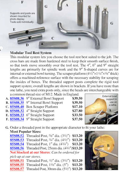

Try Shopsmith first, if no luck there, Lee Valley Tools for one do carry posts, not sure they work with the SS toolrests though..............go here (hope this is helpful)
http://www.leevalley.com/en/Home/Online ... d=6b5f82a8
A screen capture of pg 134 is below:
[ATTACH]9914[/ATTACH]
page 134.jpg (84.28 KiB) Viewed 4034 times
Peter
