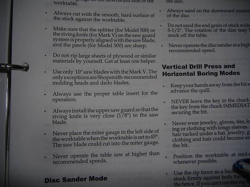

Hi,
Here is a shot of the safety sheets from Shopsmith:
[ATTACH]9992[/ATTACH]
So I'd say if you have shopsmith that was designed for 10" blades and want the safety hardware to work right (blade guards) you will want to use a 10" blades.
If the budget is limited a comb blade will do crosscuts and rips, it also works for plywood, you can decide just how well after doing some cutting.
If you plan to do a lot of plywood or just want better cuts then invest in that sort of blade next, otherwise I'd look for a better rip blade.... and better crosscut blade.
I'd keep the circular saw blade w/saw for breaking down full sheets of plywood which can be done with a guide system and saw horse arrangement.

- DSCF9000sc.jpg (91.17 KiB) Viewed 12029 times
Well whata you know about that. Those same safety rules are in my manual too. I actually got it out to read believing that it was not.
Now that this discussion has been started I would like to know just why a smaller blade is not recommended by Shopsmith. They certainly have themselves covered in the event of a "Sawstop-Like Legal Fiasco".
Is there a SAFETY Issue?

Since SS 'approves' using smaller blades distributed by them, I doubt there is a significant safety issue except for the increased(excessive) clearance between the blade and the blade slot etc. Methinks the litigatious(sp?) legal beagles are defining the 'safety rules', not the rational engineering department.
Used with a ZCI, I see(IMHO) no safety issue.
