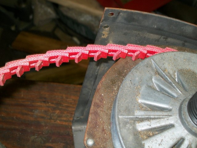

Ron309753 wrote:Bill,
I'm going to pick up a Powertwist belt this weekend to put on my greenie. I know you use 35 links. Does it make any difference which way the links are pointing (if that makes sense)? Also, does the Powertwist belt cause any speed restrictions until it get worn in?
Thanks,
Ron
Thanks for the question. YES, I have a specific direction that I mount the link V-belt. I want the inner tips of each link to fold down as it rotates around the sheaves. do not have a break in period when using a link belt. I stay away from min and max speed settings for a few hours.
[ATTACH]10201[/ATTACH]

Thanks for the tip, Bill. I assume that means that the link belt would not be a good choice for a reversing-direction motor like the PowerPro?
Gary
I believe the Power Pro uses two Poly V Belts. The regular belts would not be of any use there.

Well then to repeat the earlier question slightly rephrased. Then a link belt would not be advisable for the reversible Mark VII?

e.friedl wrote:Well then to repeat the earlier question slightly rephrased. Then a link belt would not be advisable for the reversible Mark VII?
Ed Friedl
I have not seen any information on the link V-belt specificing a direction. I only offered my opinion as to how I use the link V-belts. Many times I use a link belt when I have modified motor locations. No wear on steel pulleys when using the link V-belt. I do get a fine aluminum dust from the headstock sheaves when using the link V-belt. I found the wear on the sheaves from the link V-belt was acceptable to me after a few hundred hours.
In fact, I find the normal V-belt appears to wear grooves in the sheaves whereas the link V-belt leaves a nice smooth finish on the sheaves. I reface all the sheaves before using them. I have switched to using a Kevlar V-belt for my personal headstocks. I need a few hundred hours on one of my headstocks to see how much the Kevler V-belt will wear the sheaves compared to normal and link V-belts.
Ed Friedl
No they would not. Link type v-belts are generally specified for non-reversing drives. Here is an installation guide for Fenner PowerTwist Plus v-belts:[ATTACH]10217[/ATTACH]
Section IV specifies the arrow should point in the drive direction. These belts are very handy when the center to center distance of the drive is not adjustable as they can be stretched over the sheaves without the belt cord damage that normal v-belts would suffer.
