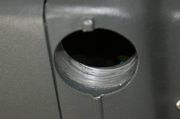

Detail of way tube bore hole
[ATTACH]10739[/ATTACH]

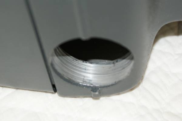

detail 2 of waytube bore hole
[ATTACH]10740[/ATTACH]

- PP headstock bores.jpg (70.6 KiB) Viewed 3806 times
- PP Headsstock bore 2.jpg (64.96 KiB) Viewed 3807 times
