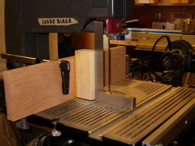

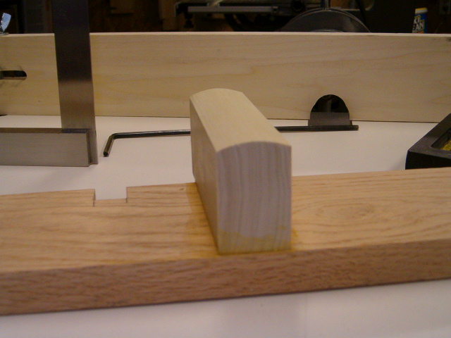

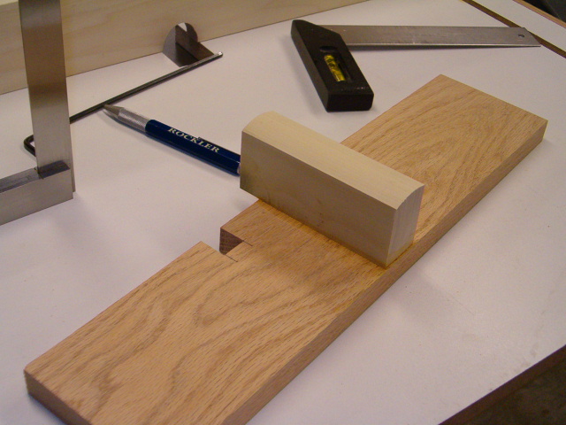

Although I don't have the cast iron table on my bandsaw, Here is a simple jig you can make that will save you the expense of buying and installing a store bought jig.big wrote:After using 1/2 blades (almost exclusively) for over a year with not problems, I decided to try the 5/8, since I mostly do re-dimensioning work. (OK, I hear everyone saying "why did you change what was working?"). At the same time, I changed the roller bearings because they were screaming.
Now, I can't get the blade to track properly. Yes, I've read the threads on set-up... I did that last year when I bought the machine and put the 1/2 blade and Cool Blocks on. It's almost like the angle of the table is off now, even thought I didn't remove the table to change the bearings. I cannot get a cut parallel with the fence.
If this makes any difference, I've noticed that I can't get the front edge of the Cool Blocks near the teeth without having the back of the blade contact the "bracket". Since I did this right before, and didn't change anything but the blade and bearings, I can't figure out what's wrong. I suppose I could mount the table crooked, but that seems like a sorry workaround.
Thoughts?
[ATTACH]10911[/ATTACH]
[ATTACH]10912[/ATTACH]
[ATTACH]10913[/ATTACH]
The block is curved, as you can see. When clamping the jig to the fence, the center of the block (the outermost part) is aligned with the tip of the blades teeth. To use the jig scribe a line (pencil will work) down the edge of the board to be re-sawn. Then adjust the fence and follow the line. This allows the operator to adjust the position of the workpiece to offset with any drift.
I wouldn't worry about teeth of the 5/8" blade edging a bit in front of the upper tire. This is probably caused by the tilt of the upper wheel - which is a good thing!
As said above, the position of the blade is set by the guide bearings. As for your blade rubbing on the "bracket" - this should not happen as the bearing should keep the blade from this rubbing. EDIT!! Whoops! Yes, you can put the "cool blocks" close enough to the teeth of a 5/8" blade to cause the back of the blade to rub on the bracket. The blocks only need to be backed off a little to end the issue.
You have been lucky in the past with your 1/2" blades working with no drift. Drift is a normal thing because of teeth slightly offset more on one side of the blade than the other. (also grain changes can cause drift) That's why I like my little jig so much. I can hold a straight line re-sawing very easily.
