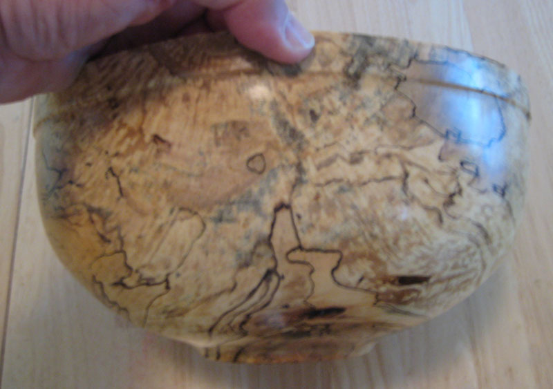

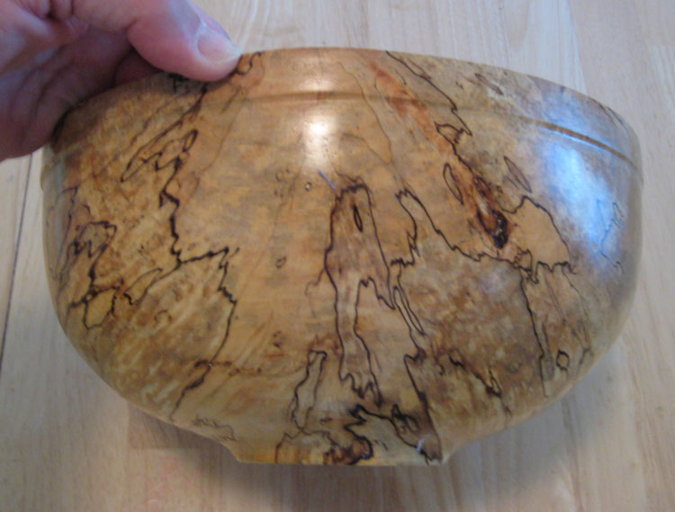

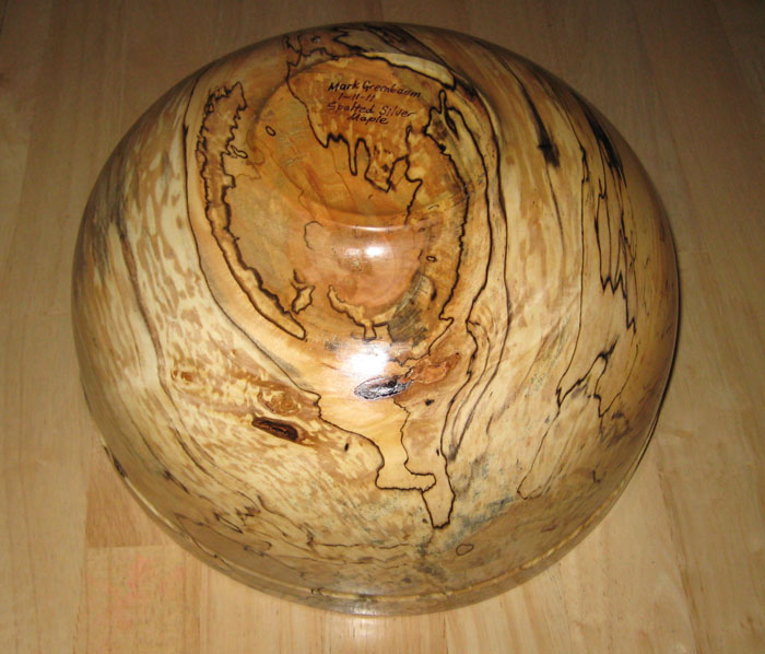

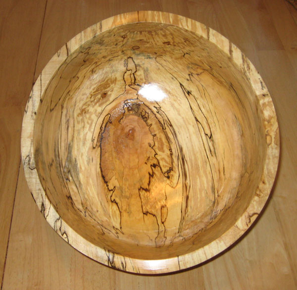

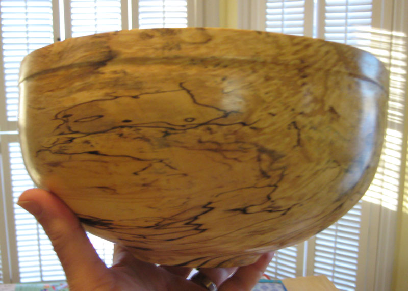

Post by mgdesigns »
Photos: Spalted Silver Maple Bowl - measures about 11.5" diameter x 5.5" high. It's my first big bowl turning (not a guitar, I know, but woodworking and finishing). I still have a lot more shellac to apply to it.

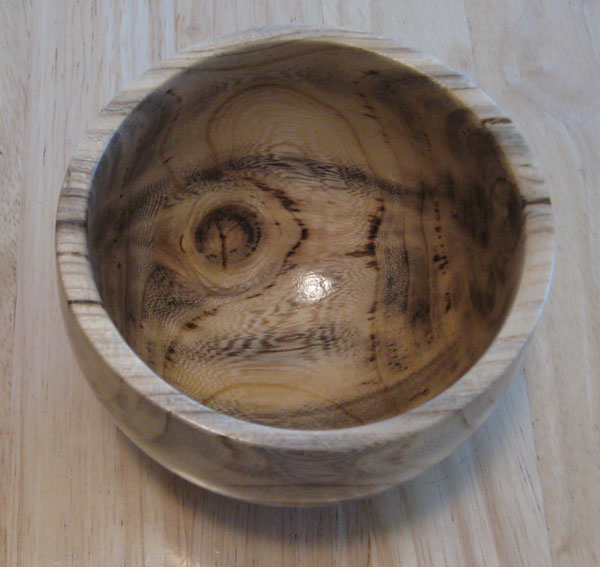

Post by mgdesigns »

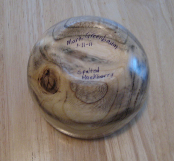

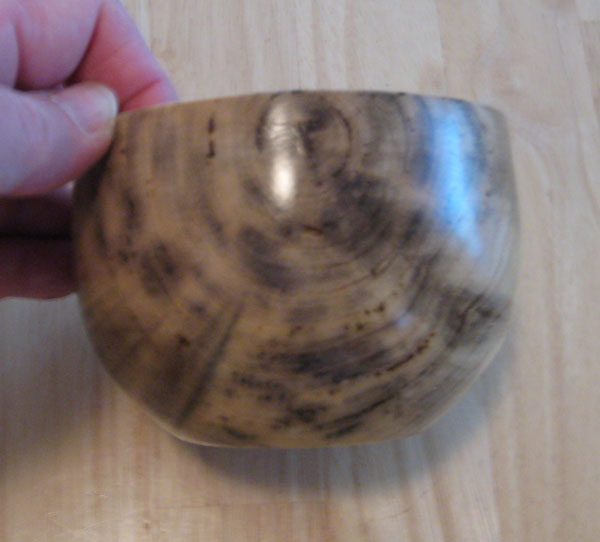

And here's the smaller Spalted Hackberry Bowl. It measures about 5.5" diameter and about 3.25" high.
I hope you can appreciate the finish of this technique. It is a bit more hands-on than just spraying, but the high luster and the durability are fairly good. As long as water does not sit on the finish it is pretty resistant. And it is easily repaired; just add more denatured shellac mixture and buff, I was also told you can apply anything over it, and it can go over anything. And it's BUG SPIT!!

Nice finish, but even nicer turning. That maple bowl has got it right!!!! Nice detail(bottom, lip)!

Nice job! I like how you have signed, dated and identified the wood species on the bottom of your bowls.
