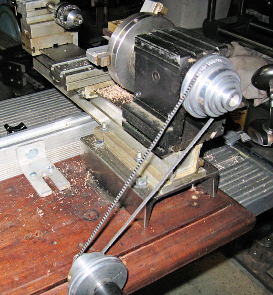

I used the motor off my Taig lathe on another project and thought of replacing it with my Shopsmith.
[ATTACH]11958[/ATTACH]

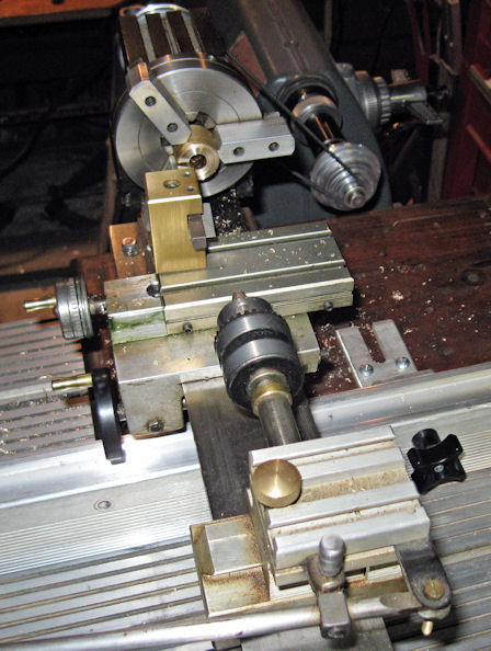

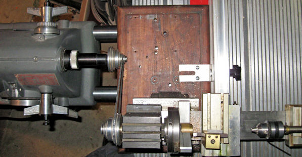

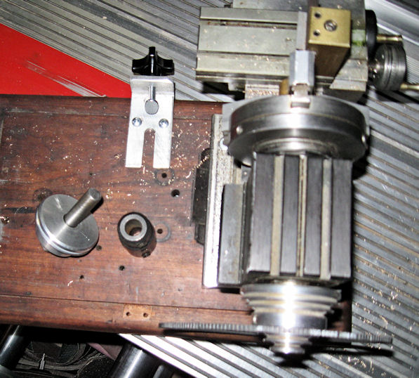

I used a ½” router bit adapter to hold a Taig pulley on the SS headstock spindle. I left the Taig on the old wood base I had it on and snugged it up next to the fence using an aluminum angle and a ¼” bolt through the fence’s center hole.
[ATTACH]11959[/ATTACH]
[ATTACH]11960[/ATTACH]
The pulleys are lined up by sliding the fence with Taig base attached towards the SS headstock and then locking it in place. The Taig drive belt is tightened by raising the table.
[ATTACH]11961[/ATTACH]
In the first photo, the Taig has just been used to face the end of a brass bushing. Works pretty good.

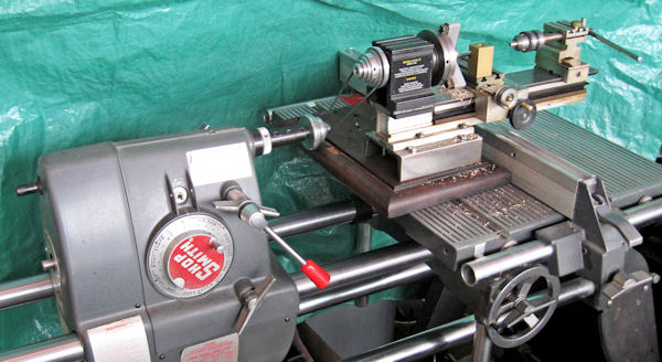

Here is a better over all view:
[ATTACH]11998[/ATTACH]
oa of taig on SS.jpg (68.14 KiB) Viewed 11383 times
Peter
