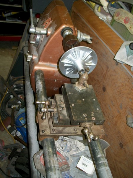

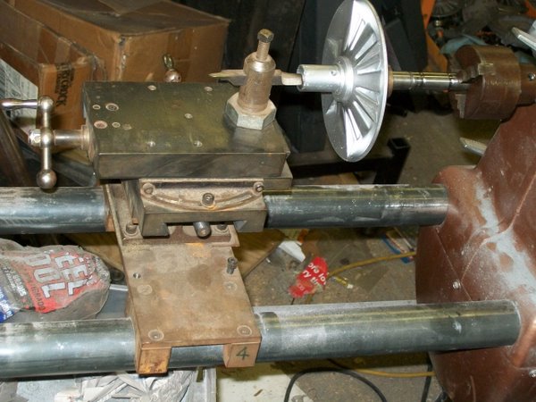

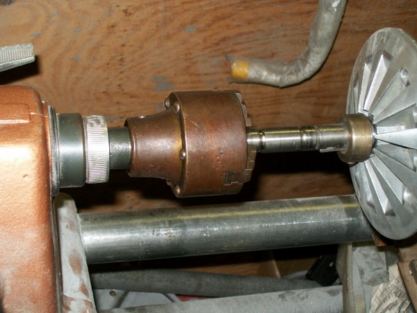

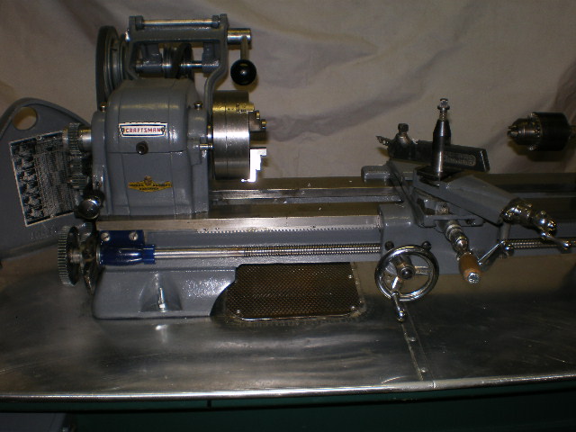

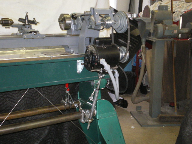

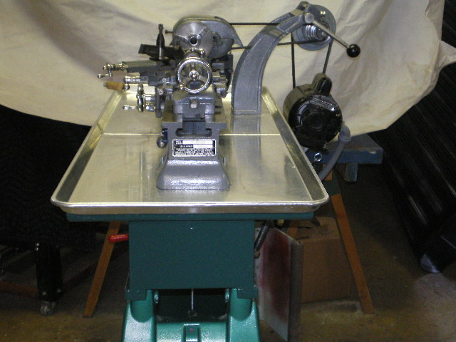

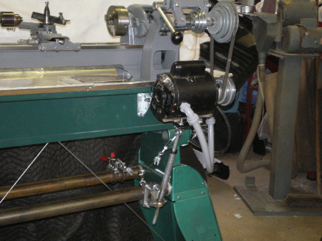

Shopsmith Use as A Metal Lathe
Thanks to Jeff Craigie for the metal lathe carriage and tool post that someone made for the Mark V. Quite a bit of effort went into designing this item. It bolts to the way tubes (bottom clamps are being painted). I added a second quill bearing to the Gilmer quill shaft behind the front one. I was able to machine a coupler insert for the smaller chuck I am now using. It is within .003" of being centered. I keep the quill lock handle tighten all the time and use the lathe carriage to move the tool bit. I shim the idler shaft (no bearing) in the chuck for .001 accuracy to hold the Control Sheave so I can machine the bearing depth another 1/16" - 1/8" deeper so I have room to stake the bearing. Most of my Control Sheaves have different bearing depths so I leave room for oil (end of the idler shaft to the bearing distance). Slow is the word when using this tool. I can adjust the cross feed angle to do the faces for all the sheaves to remove scratches, dents, worn areas and flatten vane tips.
[ATTACH]12811[/ATTACH]
[ATTACH]12812[/ATTACH]
[ATTACH]12813[/ATTACH]
This is currently mounted on my tube cleaning, sanding and polishing Shopsmith. I plan to shift this tool to my Mark VII when I finish restoring it. I am hoping to pick up 2 Craftsman metal lathes (109-702 & 109-703) tomorrow to rebuild and use in place of my HF 7X10 metal lathe.
I am looking for one caster and barrel for the Mark VII as one was broken. Please contact me if any questions or responses.
