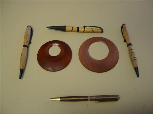

thanks the boiling for about 30 mintues did work,
pen on the left with a few offset turning i did.
http://www.chromewiretie.com/pendentanpens.jpg
pennview
Posts: 1634
Post by pennview »
Looking good!
Art in Western Pennsylvania
