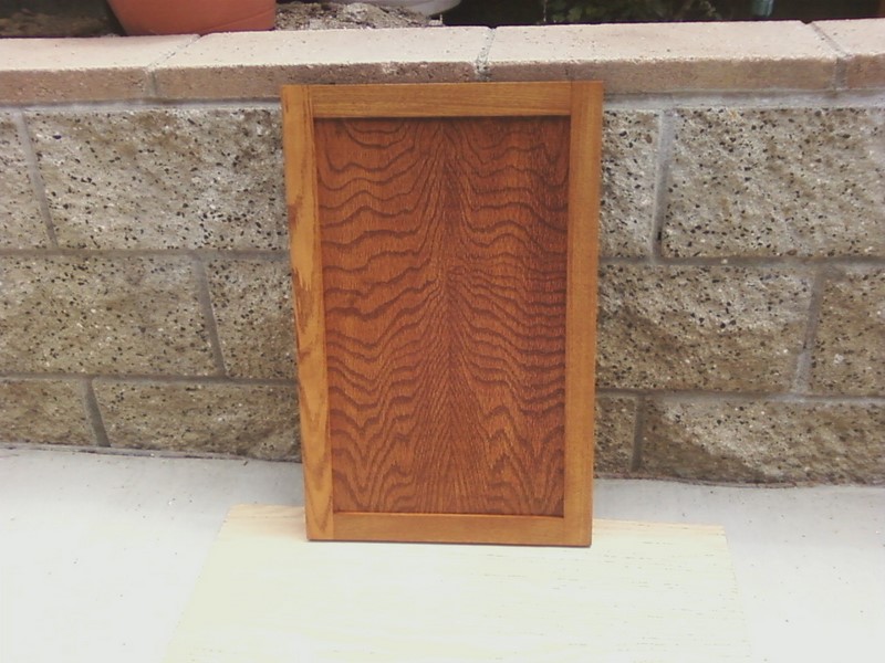

Here are the results of my query. I stained the panel and applied one coat of finish AND stained the shoulders of the groove on the rails and stiles. I then glued and fitted the door in the carcass. After fitting the door, I stained and applied on coat of finish on the rails and stiles. Once dried, I applied a second coat of finish on both sides of the door. The result was a beautiful book matched door. I'll do all future frame and panel doors using this method.

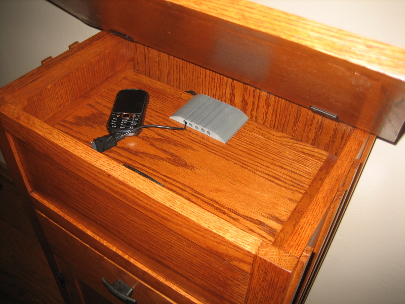

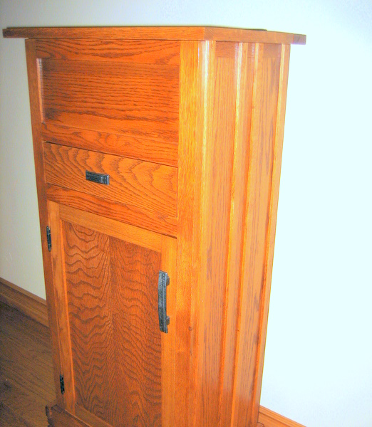

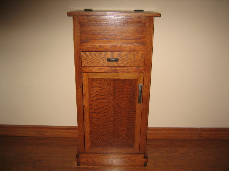

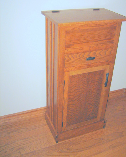

Here are some pics of the book matched door and the finished project. I call it a Hall secetary. The lid opens up to reveal a hidden compartment under the removable shelf for electronic chargers. The electronics (cell phones, etc) plug in and charge on the shelf. The drawer is for car keys, glasses, etc. The door area is for purses.
The electrical plug strip is in the hidden compartment and the cord is hidden in the door area behind a grooved cleat and exits in a desk grommet in the lower shelf.
It is made of white and red oak solid hardwood and 3/4" grade A1 oak plywood.
