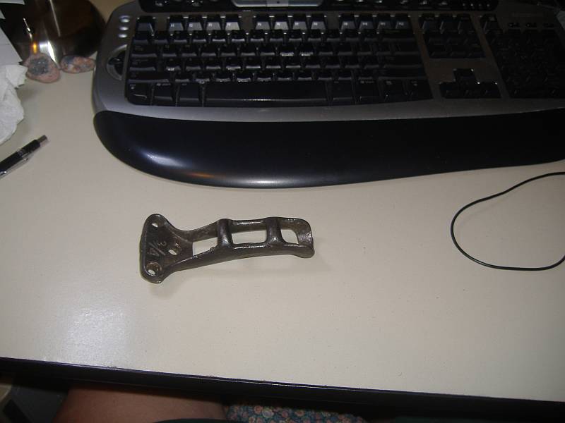

Picture this:
[ATTACH]13595[/ATTACH]
A flag pole bracket that has been house painted over way to many time. The paint was so thick the flag pole would not even fit in it anymore. I saw it and felt the heft and knew it had to be a cast part, nothing like the folded sheet metal stuff I have at home. So it followed me home and has sat around a year or two or three wait for me to clean it up. Now with the crock pot to play with this seem the time to give it a try.

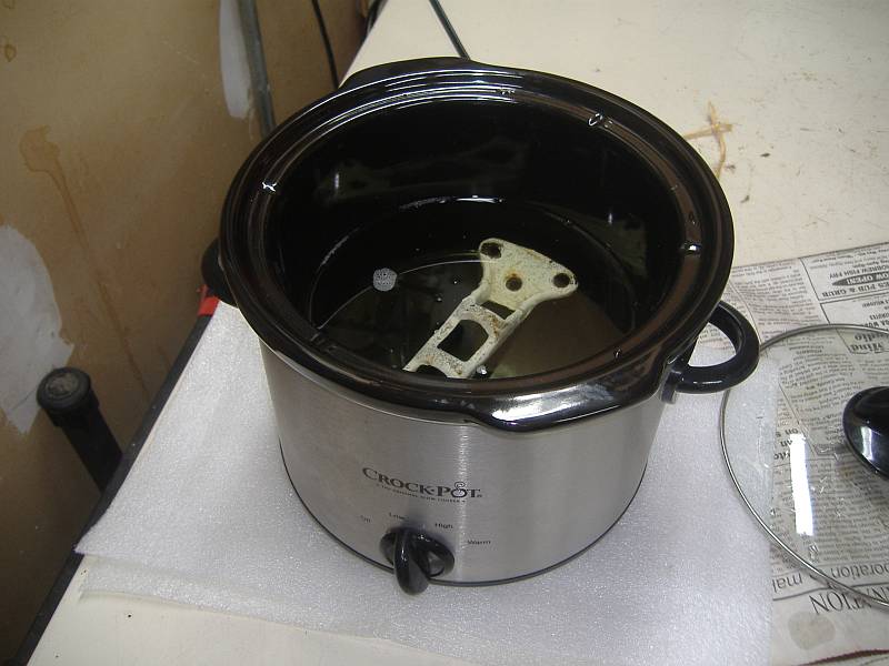

Water and about a 1/4 cup simple green and in goes the part.

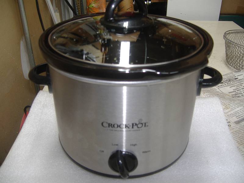

I covered it and set it on low for an over night run.

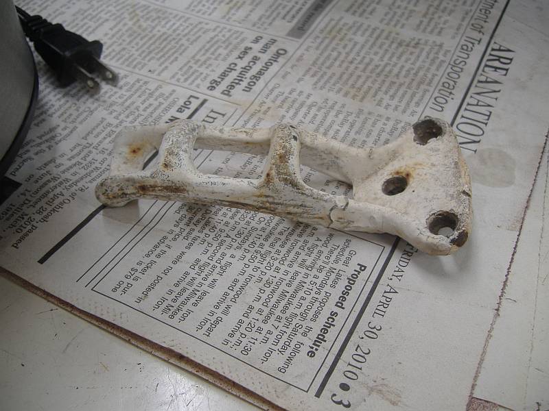

When I came back in the morning a lot of the paint had come off and I got to excited that I forgot to take time to take pictures. Most of the remaining paint came off with the use of a putty knife and tooth brush. A few areas needed some extra work and I should have put it back in the pot but elected to work a little harder and clean it up. It is cast so the ruff surfaces in a few places required the use of a wire brush.
Results:
[ATTACH]13598[/ATTACH]
I have done a limited amount of items and thus far only with simple green. I have been very happy with the results.
Let me conclude with a few other things I have learned.
One item with baked in cooking grease had a not so pleasant smell in the morning, so I'm glad it was done in the garage. Other just painted things smell mostly like the simple green.
I have been using old t-shirt fabric to filter the paint out of the solution, then tossing it into the garbage. I guess if it happened to be old lead paint one might want to rethink things.
The pot gets residue from the process and needs to be cleaned after a project. Might want to revisit cooking time to limit water loss. So far I have been just doing it over night. The residue seems to form where the water level is/was.
