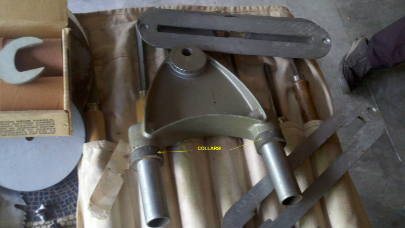

I think I am missing the collars for the lathe tailstock.
http://www.shopsmith.com/ownersite/itemfind.htm?item=505990&Submit=Find+Item
Make sure it is a greenie one. The bench tube mounting is different due to the larger(1 7/8") bench tubes.
They are cheaper from ss than typical on e-bay!
Cheaper(a little larger) from industrial supply house.
- Posts: 35435
P.S. You already have them.
[ATTACH]13705[/ATTACH]
