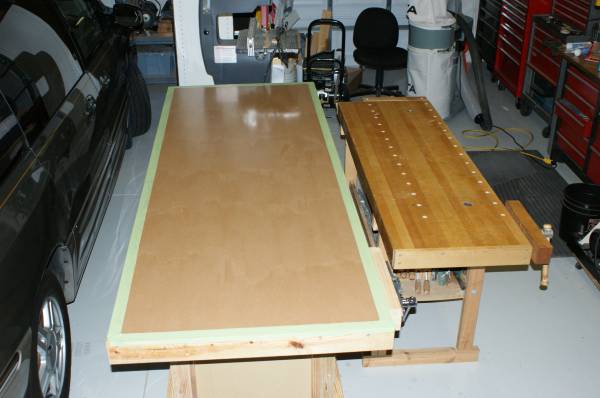

I have built that workbench from Woodsmith TV show and it is one HEAVY bench. I put a vise at each end of the bench and I got mine from Harbor Freight Tools. The HF ones are cast iron and have a quick adjust feature and price runs about $60. The one in the popular catalogs are about twice the price. The photo shows the new bench with my old Sjobergs bench. The new one has more than twice the surface area of the old one
New and old bench
[ATTACH]14044[/ATTACH]
Bill V
New and old bench
Bill V
- new and old bench.jpg (82.51 KiB) Viewed 4102 times

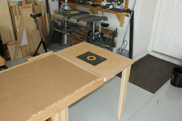

I could not post a second pic so I am typing again. I buried the vise behind the front edging on the bench and also added a router table later. The router table can be removed if necessary but it serves as an extra work surface. This makes the bench almost 9 feet long which is good for assembling long items such as bookcases or tall cabinets.
Bill V
Workbench with router table attached
[ATTACH]14045[/ATTACH]
Bill V
- workbench and router table.jpg (78.33 KiB) Viewed 4101 times
