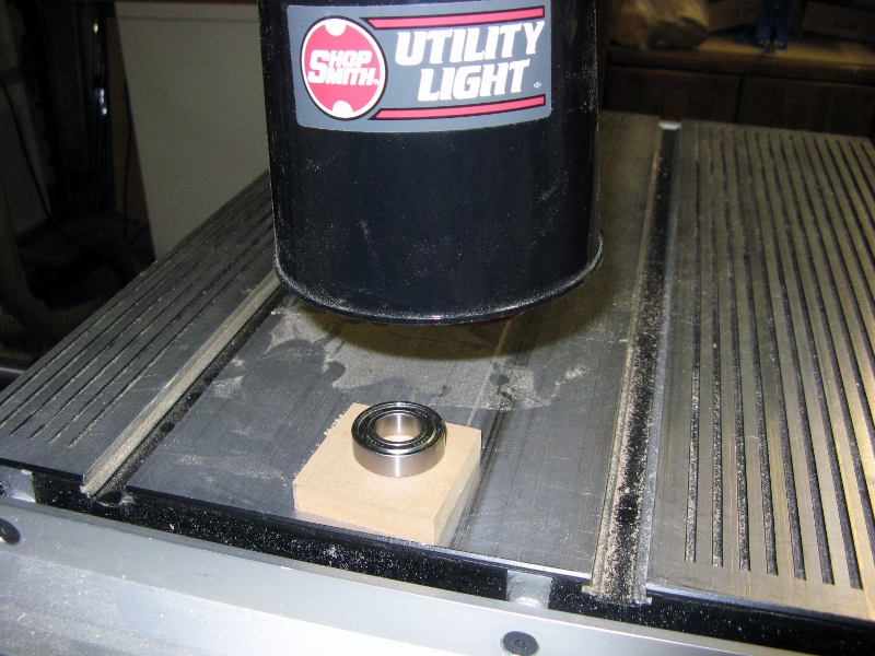

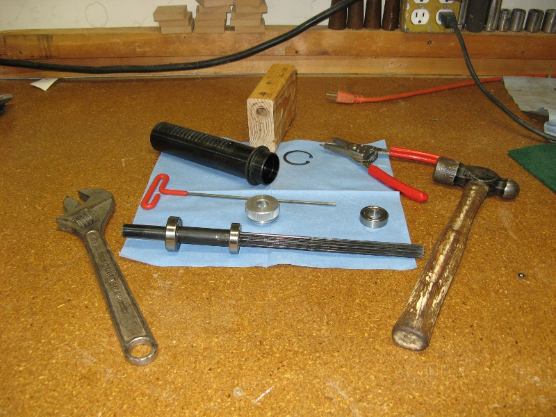

The bearing type was a 6003z after doing a spec comparison I ordered a 6003rs ($4.27 including shipping). This bearing met or exceeded all 6003z specs plus it was sealed. After removing the shaft from the quill I placed the shaft with the bearings in place in the freezer (under the frozen peas so SWMBO would not find it). Meanwhile I drilled a 5/8 hole in the end of a scrap 2x4 to hold the spindle shaft and to cushion the splined end of the shaft. I also placed the new bearing under a lamp to heat it.

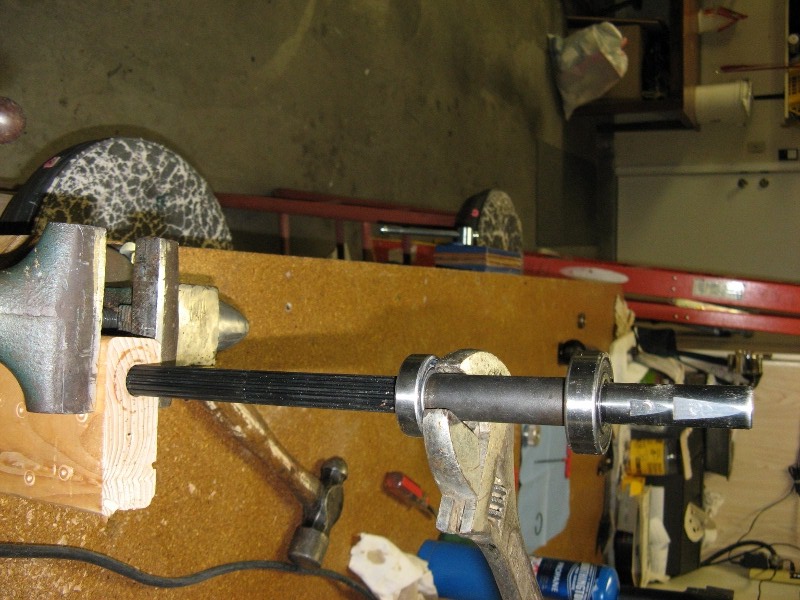

After removing the shaft from the freezer I placed the block in the vice, inserted the shaft heated the outside of the bearing and give it a good knock with a BFH (big fun hammer) the bearing popped right off.
[ATTACH]15727[/ATTACH]

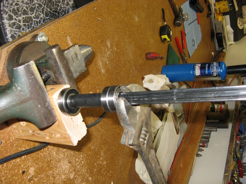

I then rotated the shaft reinserted it in the block placed the new heated bearing in place and used the old bearing to drive the new on in place.
[ATTACH]15725[/ATTACH]

P.S. Next(?) time put a spacer(washer) between the outer bearing(the bigger shaft output end one) and that 2x4 with 5/8"(+) hole so as to not press against the outer race when driving the rear bearing on(and vice versa if replacing the big one!)..
