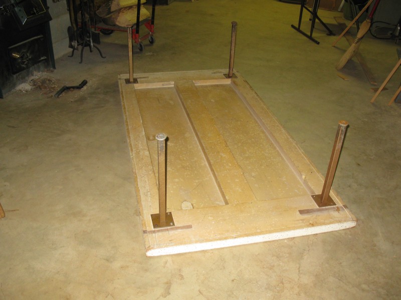

I have had a table stored back that was originally a store fixture out of my grandmother's store from years ago. It was 3' X 6' X 18" tall.
[ATTACH]15842[/ATTACH]
It has sturdy steel legs and a 1 1/2" frame tenoned together. The frame is heavy enough for clamping around the edge.

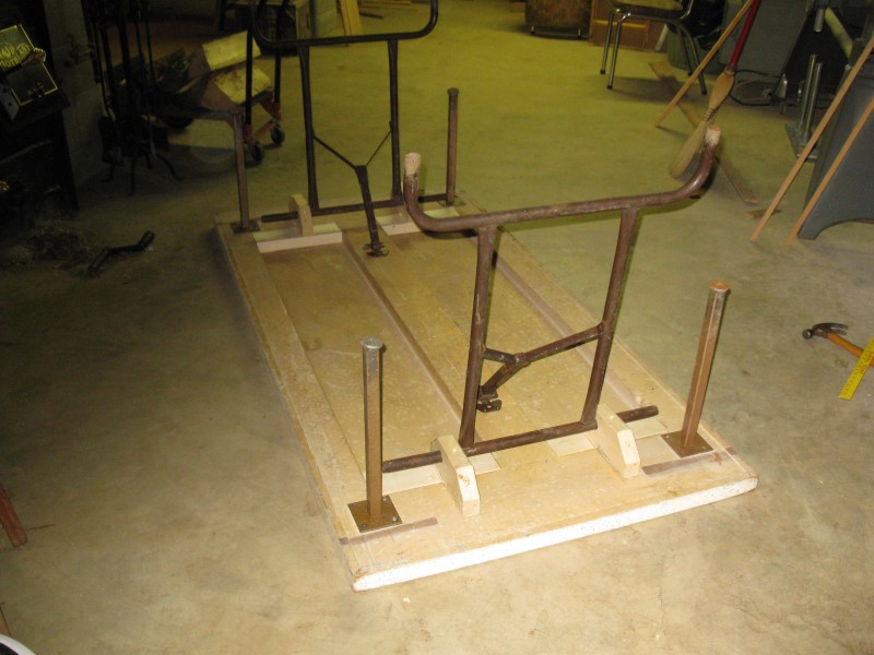

One of the things I have accumulated over the years is a batch of banquet table hardware, mostly from yard sales. I grabbed a pair of legs and using a batch of 2" X 4" cut-offs and a good bit of Tite-bond I mounted them to the old display table.

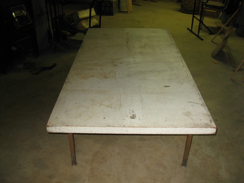

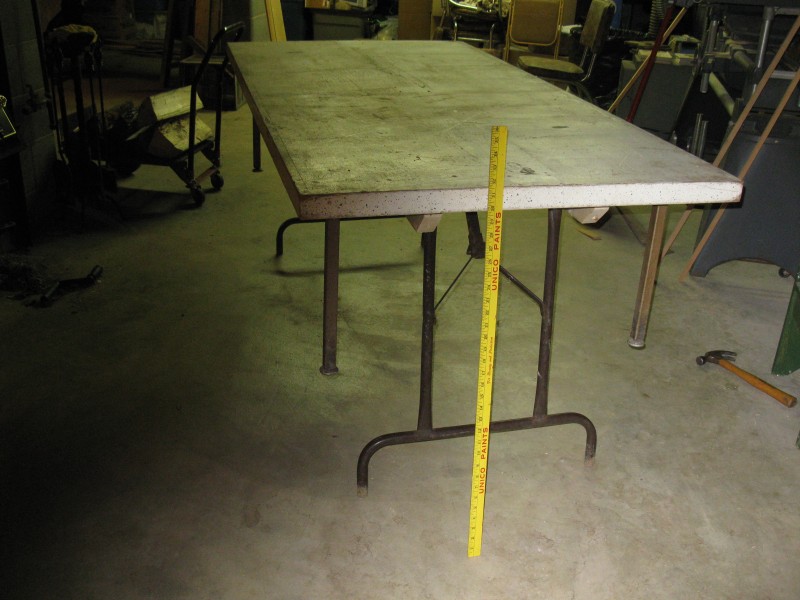

Now I can use it at either 18" with the banquet table legs folded or at just over 31" with them extended.

I still use a "banquet" type table with the above type of folding legs for sharpening tools while seated. However, this height is too low for working while standing, requiring bending my back and neck, which is uncomfortable for any extended periods of working.
I've followed Christopher Schwarz's advice that a workbench height should be such that while standing, your outstretched palm should just settle on the surface. For me, at my height of 5' 9'', this height is about 34 inches. The reasoning here is that your whole body is involved in the work, not just your arms and shoulders. Handplaning would be a good example.
The height of a bench is not arbitrary, indeed some serious thought should be given in order to create a workplace that "fits" you individually, and will enable you to work without undue fatigue and strain.
When planning the new shop I gave serious thought to an adjustable height table. Lower for project assembly like the sewing cabinets, higher for smaller projects. I ran out of time and space prior to building it. After building the sewing cabinets I realized assembly works better for me at the higher, standard workbench height. For my height that is under 30". My only remaining issue was moving the cabinets to the floor or back up on the bench. The new hydraulic lift table removes that obstacle. I have a twelve inch section of railroad rail that I often use as an anvil. Last weekend I needed it on the bench, yeah I store it on the floor (actually on a block of wood about six inches above the floor.) I tried to lift it and my arm reminded me that isn't an option. The lift table lifted it up, I used it and returned it to the floor. Man I love intelligent tools. Jim

8iowa wrote:I still use a "banquet" type table with the above type of folding legs for sharpening tools while seated. However, this height is too low for working while standing, requiring bending my back and neck, which is uncomfortable for any extended periods of working.
I agree... My work bench is "about" 36". There I work mostly on "boards"
I also have several heights of stools so I can make things kind of fit.
The reason I jumped on this project now is that I need to quickly build a pair of utility shelves for Xmas decorations. They will be 6' tall by 3' wide and 8' long. In the old days I might have built them on the floor. That won't work today.
