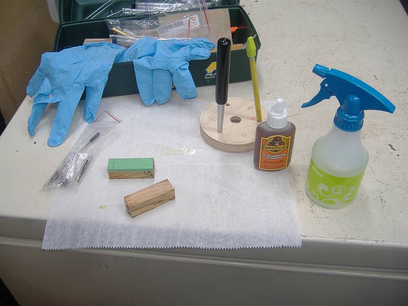

I marked the pen blank (olive wood) using tape.
Then things started getting foggy again. Since as I understand it the center portion of the pen should have matching grain. This means a single cut some where in the center is needed. The instructions say you need to have the wood about a 1/4" longer the the brass (tubes inserted in the middle of the wood). The "extra" material would then have to be trimmed off the ends. There will be about 1/8" sanded away from each of the blanks to get to the brass tubes, so the grain is somewhere from 1/4" plus a saw kerf away from matching but then there it is the center band on the pen that would cause some spacing for your eyes to "blend" any differences.... OK maybe I'm over thinking this. Decision was keep it simple and wait and see.

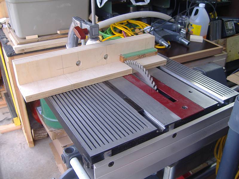

I used my miter sled to cut the blank into the segments.
[ATTACH]15988[/ATTACH]

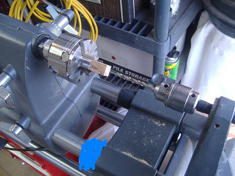

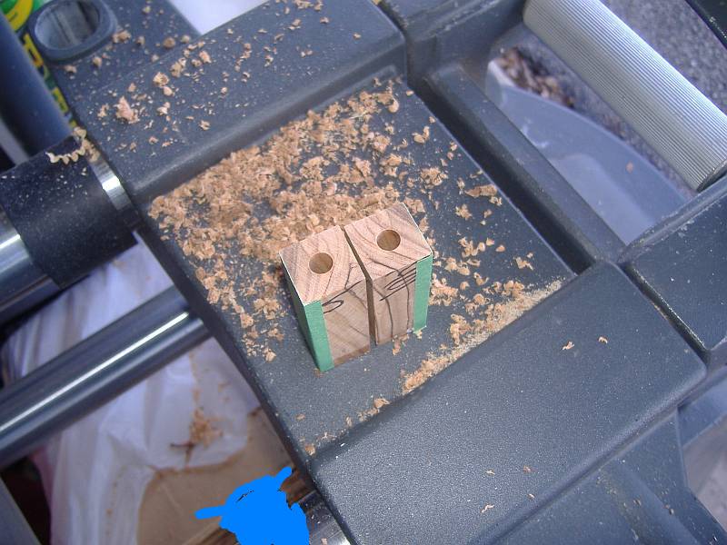

Drilled the blanks.
[ATTACH]15989[/ATTACH]
[ATTACH]15990[/ATTACH]

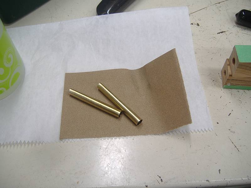

Ruffed up the brass with 220 grit paper.
[ATTACH]15991[/ATTACH]
Glued and now drying until tomorrow or another day when it is warm enough to work again.
[ATTACH]15992[/ATTACH]

Ed,
Great job, Keep up the good work. When I assemble my brass tubes and wood blanks, I attempt to get the brass tube even with the center ends of both blanks. My process is to draw a line along the center portion of one side of wood prior to cutting into two blank sections. Then I draw a line across 1/2 of ends of the centers. This way I can line up the blanks to keep the grain together. I seldom cut either blank more than 1/8" longer than the brass tubes. Once all glue is dried I take a marker and mark the insides of the brass tubes adjacent to the end marks on blanks. I find that the end marks on the wood generally disappears in finishing process. Jim

Hi Jim,
As of now I have tape on the parts so there is no way I can confuse them. I plan to keep it that way until I am ready to turn, then I'll mark them and remove the tape.
I was wondering about why the wood needed to be a 1/4" longer but since I'm new at this I went with the instructions. I'll mark the paper in pencil to read 1/8" for take two.

Hmmmmmmm. Wonder what Ed is covering up this time!?:rolleyes: Adjustable stop collar for the carriage?:D
- robinson46176
- Posts: 4182
JPG40504 wrote:Hmmmmmmm. Wonder what Ed is covering up this time!?:rolleyes: Adjustable stop collar for the carriage?:D
I too was wondering about that...
I would have probably just laid a shop rag over it.
Would have been far less conspicuous!;)robinson46176 wrote:I too was wondering about that...![]()
Me thinks it was 'overlooked' at 'camera' time!:D Again!:eek:
my take
I haven't turned a pen in a long time, but memory says that I drilled my blanks before splitting them in half. That way the grain is more closely aligned (which can show on something so small) and I only had to drill the wood for a given pen one time.
