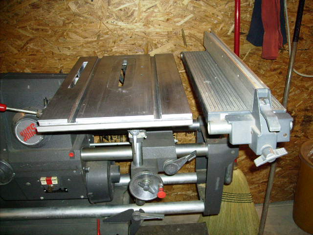

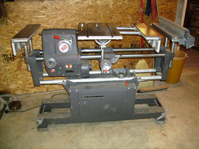

Here are the pics I took this morning of a couple of table configurations.
I happen to have an extra Mark VII "L" shaped extension table. Here the Mark VII fence is on the end mounted extension. A wide 500 extension is mounted on the left end and a 500 fence will of course fit it if wanted. The Mark VII table mounted extension is pulled out to the maximum 27" total width.
[ATTACH]16073[/ATTACH]
Here my 510 wide extension is mounted on the left along with the 510 fence.
[ATTACH]16074[/ATTACH]
Here the 510 extension and fence are on the right and the Mark VII extension is on the left. Just some possibilities.
[ATTACH]16075[/ATTACH]

What is the purpose of the table having the L shape to it?
Heath
Central Louisiana
Central Louisiana
- robinson46176
- Posts: 4182
heathicus wrote:What is the purpose of the table having the L shape to it?
So that you can use it either into the side of the main table or in the regular end sockets. By being an "L" it does not have to have moving parts to do that.
Ah, I see, said the blind man!
