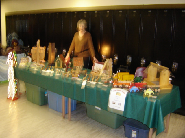

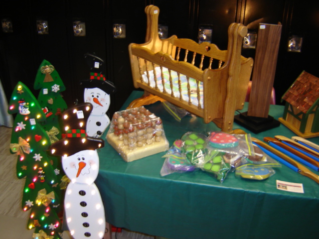

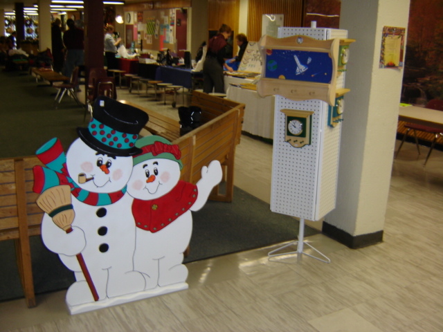

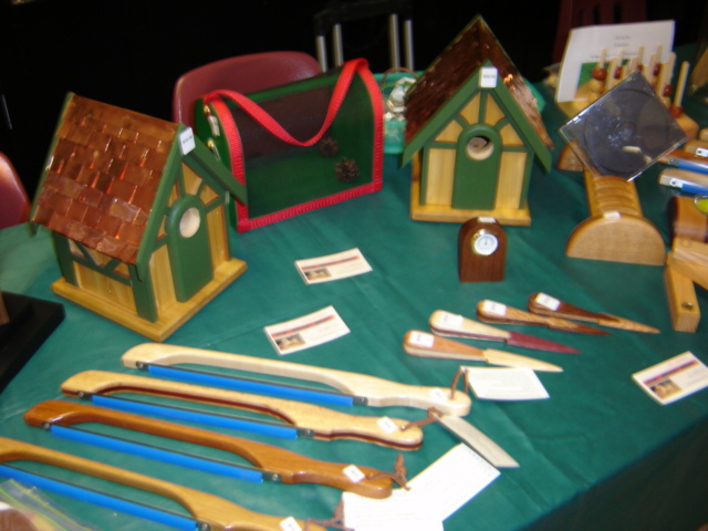

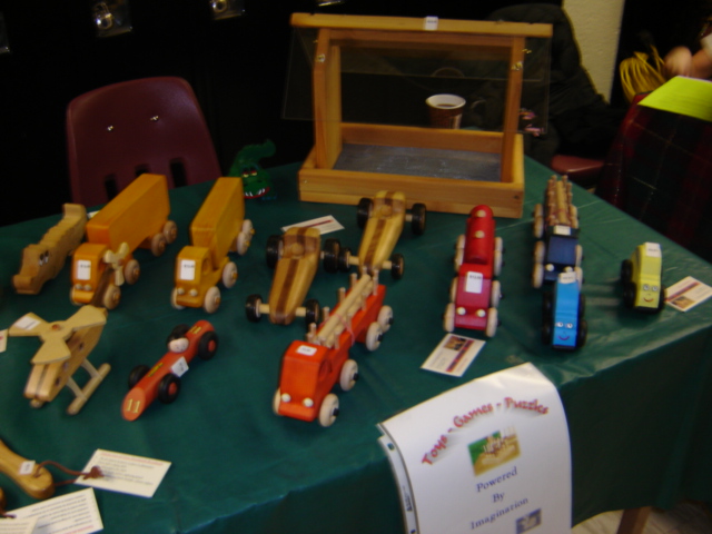

A very busy week is finally over. I've been working overtime preparing for the show, well maybe not really, managed to play one hockey game and watch 3 on TV, and the plasterer came on Thursday to start doing his thing. He comes back tomorrow so after I sign off, I must break down the PC set-up for the third time this month.
I had a fairly good show today. It's always interesting to see what sells and what dosen't from one year to the next. The three new trucks sold almost immediately (thanks I presume to the bad news from China), but two transport trucks of the same design, made in 2004, were still on the table at the end of the day. Five of eight bread knives sold so they seemed popular, as did my two four dimensional tic-tac-toe games. The Mr. & Mrs. Frosty went but the lighted snowmen and Christmas trees that were popular in other years stayed on the floor.
Besides the sales, the meeting people and getting feedback on your work is the fun part of these events. I also get to meet a few fellow woodworkers and discuss our respective hobbies and favourite projects.
I have attached some pictures but it seems the ground was shaking when I snapped some of them. The "boss" is featured in the first one. Without her, I would be lost in packing and setting up all this stuff. I bought her flowers before the show just to cover all my bases!

John - Looks like you had a successful show event. Thanks for sending the photo of your better half! She is not only supportive, but also quite talented as shown in the painting of your creations. Hope you both got home in time to break out your snow gear!

The photos of your table at the craft show were great. They really took me back in time as my wife and I used to do much the same thing each year around this time. Toy cars, trucks, and boats, trivets, holiday crafts, Frosty the Snowman candy cane holders, etc. all come back to mind!
