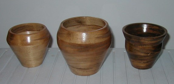

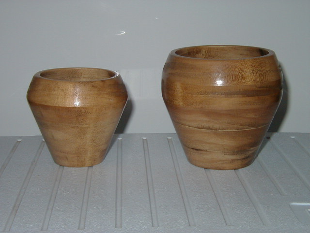

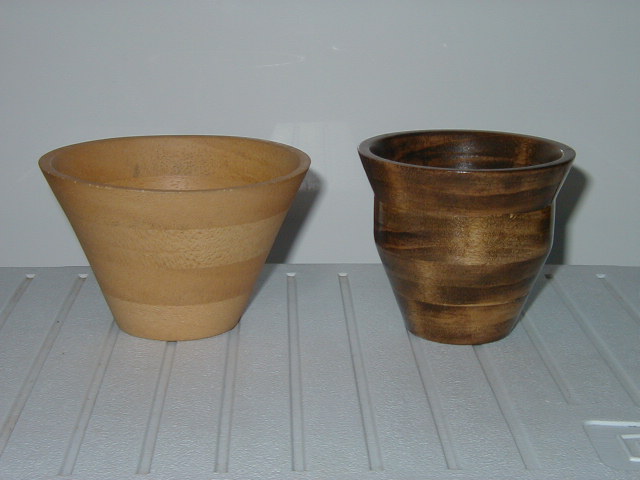

I purchased one a number of years ago and made some bowls. Other things have slowed my woodworking for a while and I hope to use the Ring Master again soon. I've attached pictures of the first bowls I made. Three of them are poplar which explains the uneven stain. They're just a small example of what the machine will do. The trickiest part is getting the glued-up stack symmetrical but its really not that hard. People are always quite amazed when they find out the bowl was made from a flat board.

I don't have a ringmaster, but I have made a few bowls using a parting tool to separate the rings. Works fine but I always find it a bit nerve-wracking at the instant each ring is released. Yes, they do fall back onto the quill and (eventually) stop spinning, but for a few seconds you've got a bouncing chunk of wood which keeps your adrenaline going nicely. I make sure I don't drink too much coffee in the morning before I try this!:rolleyes:
I really would like to get a Sand Flee to sand the rings smooth and flat before glue-up. So far I've just taped sheets of sandpaper down on a flat surface and used elbow grease. Works fine but takes too much time.
