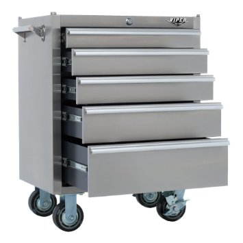

dgale wrote:oldiron wrote:Hi Folks! New guy here! I realize this is a old post however, Does anyone have any pictures to show with a 10ER wall mounted? I want to try it out myself.
Sorry for the delay in responding...I've been MIA for a while juggling work, kids and saw dust creation. Here are a couple pictures of the 10E I mounted to the wall as a dedicated drill press:
Good to have you back, dgale! I have both of your wall-mount drill press photos salted away in my "inspirations" folder. Mine will be going up this winter. Unfortunately it won't look as cool as yours, because my wall is sheathed in white pegboard. But I did figure out one improvement. By mounting the base a little higher up higher on the wall, I'll have room to park a 26" mobile tool-chest base underneath it, in the same footprint, and still keep the table at a comfortable level.
- image.jpeg (23.17 KiB) Viewed 10412 times
I got a great deal on a slightly damaged Amazon return, but a shop-made cabinet would also work great.
Re: Dedicated Drill Press - 10ER or Mark 5??? Advice Please
Posted: Thu Oct 01, 2015 1:35 pm
by dgale
I like the idea of a storage cabinet underneath and may end up raising mine and doing the same when storage needs catch up with me. I stuck that little recycled kitchen cabinet up next to it for a short term fix but obviously not serving my needs very well. I've been planning on making a larger wall mount cabinet for storage next to it but underneath may work better and be an easier fix. I also need to get my speed changer mounted on that thing.
