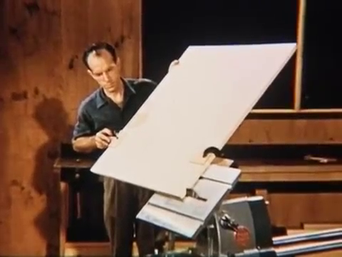

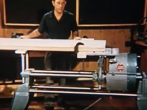

There is a way to make such cuts on a 500. The trick is to use the side of the main table as a guide.
What you do is get a straight edge, say about 4 feet long that you clamp squarely to the workpiece parallel to the line of cut so that the distance from the edge of the table to the cut line is correct. The board is below the work piece. Then you use the straight edge against the edge of the table to make the cut. I've done it many times and even have a jig for doing so.
This pre-dates my shopsmith days so it is an old trick but will not work on all saws.
You also may need add additional support for the ends of the workpiece depending on just how long the workpiece is.
I believe this is in one or more of the PTWFE's.

The old time shopsmith videos that have just been published show what I was previously describing.
You can go to http://www.shopsmith.com/ss_forum/viewt ... =7&t=15740
Direct link to YouTube
https://www.youtube.com/watch?v=n5QP27eMXMI
and look for the table saw one. You can watch the whole video or slide to the 11:30 mark followed by more at 14:21.
