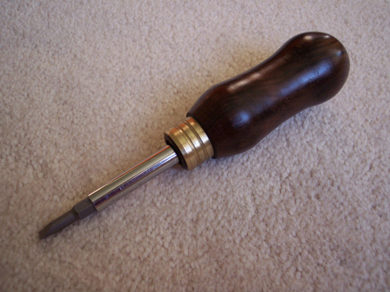

Greetings!
I've turned screwdrivers before, such as shown in my other thread:
https://forum.shopsmith.com/viewtopic.php?t=7363
My latest trick is to alter the turning/assembly sequence so I can actually turn a bit of decoration into the Brass Ferrule. I like how this has dressed it up:
[ATTACH]17414[/ATTACH]

Very nice work.
What kind of wood is it ?
Camerio

Are you turning the brass on your Shopsmith?

Thanks!
That wood is rosewood. So... I bored my blank and cut the 'tenon' for epoxying the ferrule onto the blank. Then I was able to use my standard parting-tool to cut some minor coves into the brass. I decided to do this because some of my earlier screwdrivers looked a little too bulky at the ferrule.
