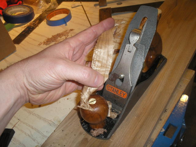

Here's my poor-man's attempt at a Lie-Nielsen plane.... applewood:
[ATTACH]12037[/ATTACH]

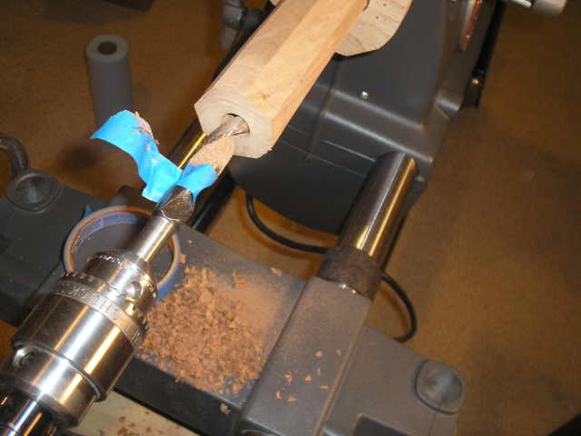

Boring the center for a screwdriver billet:
[ATTACH]12649[/ATTACH]

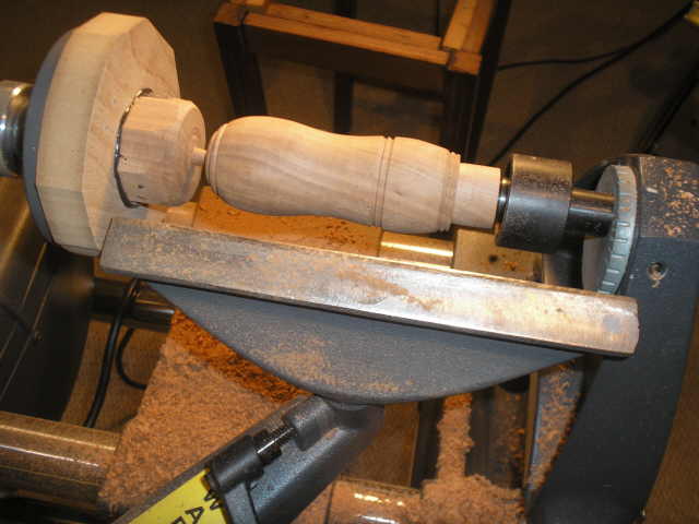

Shaping the screwdriver handle:
[ATTACH]12650[/ATTACH]

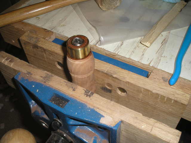

Using epoxy to glue in the tool-retainer (inner) and ferrule (outer):
[ATTACH]12651[/ATTACH]

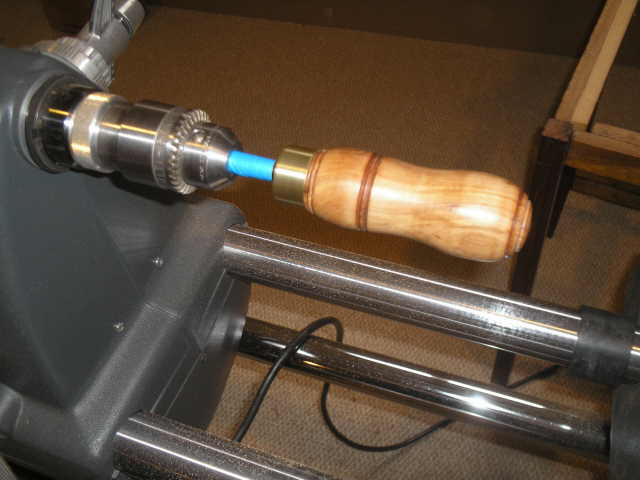

Now polishing on the lathe:
[ATTACH]12652[/ATTACH]

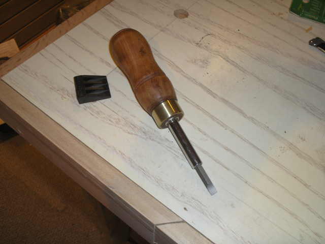

And a finished tool!
[ATTACH]12653[/ATTACH]

Where did you get the tool retainer?
Terry
Public Photos of Projects
http://sdrv.ms/MaXNLX
nuhobby
Posts: 2366
Location: Indianapolis
Post by nuhobby »
Thanks for the kind words!
This particular screwdriver was from a Rockler kit:
http://www.rockler.com/product.cfm?page ... iver%20kit
I have also used the Penn State kit which is a tad more elaborate:
http://www.pennstateind.com/store/PKSDK4.html
Both have good instructions and make great gifts when you're done.
