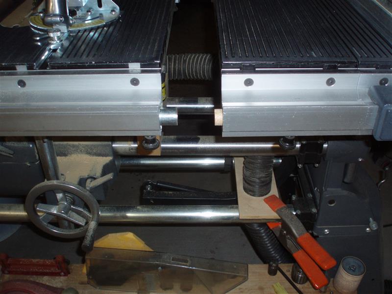

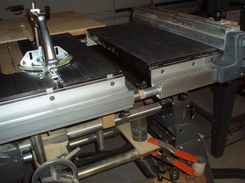

Floating Tables that are attached to ONLY the Main Table do go up and down with the Main but ...the weight must be somewhat equally distributed or there is some binding that occurs.
I own a set of long tubes that I bought off eBay but I seldom use the long tubes anymore.
So resolve the issue that the guy in Tampa complains about, I made some short couplers that I use with either two or four short tubes to tie the Main Table to the Extension Table. This way, if I want to raise or lower the Main I can do so without altering the Extension.
The long tubes can be a nuisance but if you really need to tie the tables together to handle larger jobs and to further improve table stability, they work like a charm. I would recommend that everyone with a 505 or later have a set.

dusty wrote:Floating Tables that are attached to ONLY the Main Table do go up and down with the Main but ...the weight must be somewhat equally distributed or there is some binding that occurs.

Ed in Tampa wrote:The guy from Arizona ( we apparently aren't calling each other by name any longer) has a great idea, couple's. Loosen them adjust the main table to the correct height by trial and error than once the height is dialed in adjust the extension table with a straight edge and then connect the couplers and make the cut. Works for me. Rather than having to disassemble everything so as no to bend the tubes as I raise and lower the main table. Never figured how to raise the main table and extension table at the same time.
This has been working for me (the guy in Arizona) for a while. But it may work better for me because I have the other Mark V (Shorty) and a Crafter's Station that share some of the work load.
