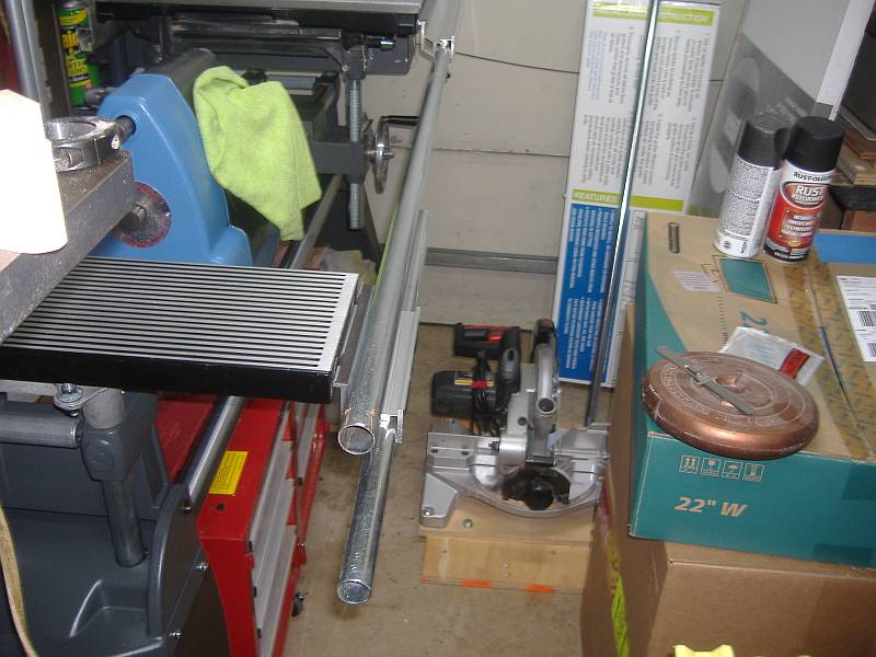

Now we go to the deflection test.
What I have done is set up the shopsmith with the main table at one end, the 5 foot tube flush at the end of the table, both screws tight on the tube.
On the opposite end an extension table with short tube extended out away from the machine so the length of the tube is just longer then the extension of the 5 foot tube.
[ATTACH]17912[/ATTACH]

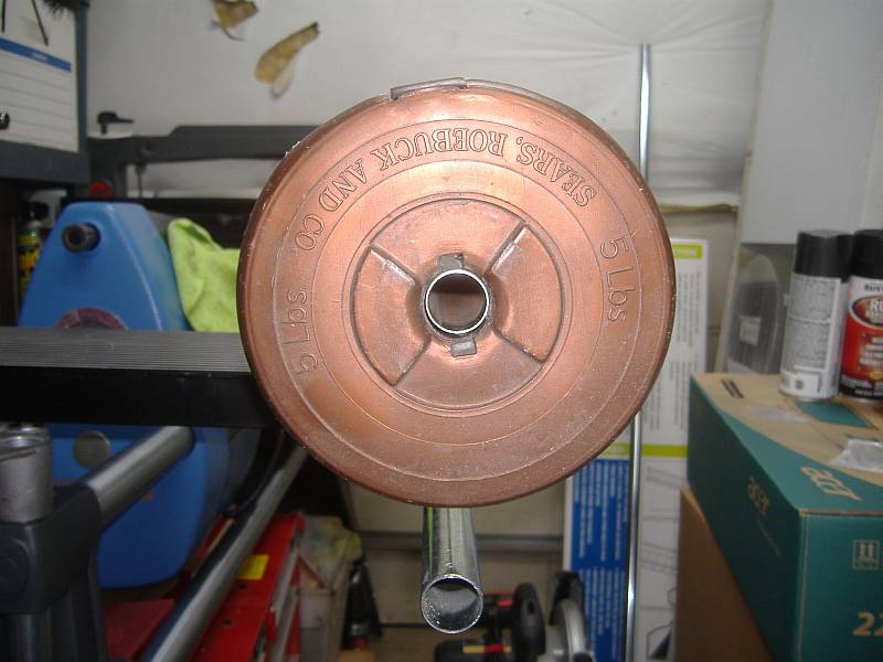

I was now able to measure the distance between tubes.
[ATTACH]17913[/ATTACH]

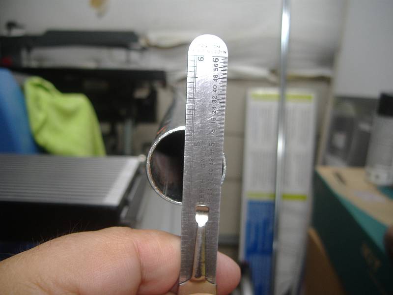

The distance was 5 3/16 as shown here.
[ATTACH]17914[/ATTACH]

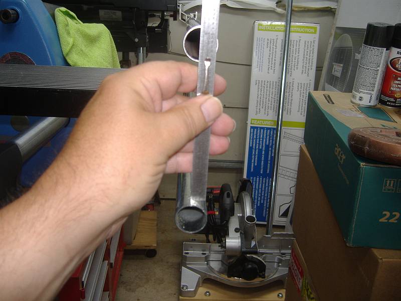

I added a 5 pound weight to the end of the 5 foot tube.
[ATTACH]17915[/ATTACH]

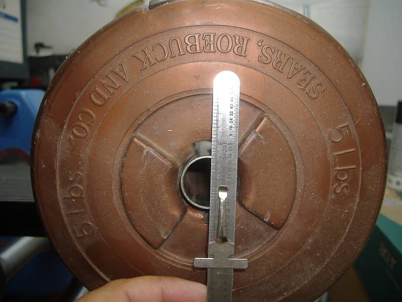

New measurement shows that it is 7/16" lower. However I could see a good deal of movement on the main table when I added the weight.
[ATTACH]17916[/ATTACH]
The ebay tube was next in line for testing and that will be in the next post.
