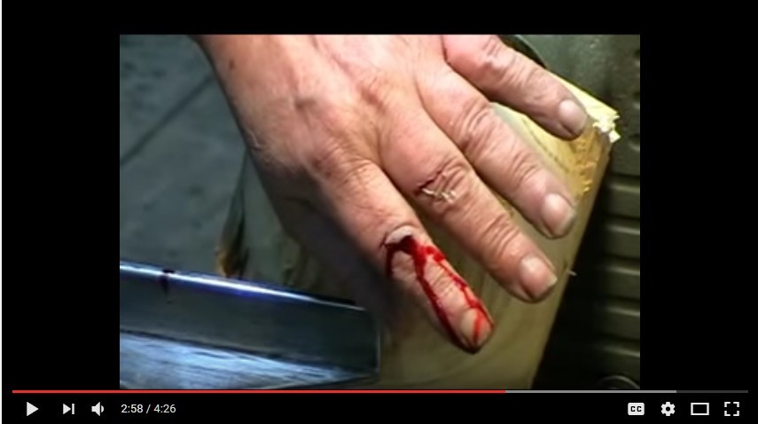

Watch this video and then decide:
https://www.youtube.com/watch?v=IOhHeyoZLaY
If you don't feel like watching the whole thing then this will give you the idea of what can happen when using a spindle gouge for bowl work.
I'll post a capture from the video but down lower with the warning that there is blood involved so don't go there if you don't want to see it.
spindle gouge for bowls not.jpg (47.8 KiB) Viewed 20160 times

Never, Never, Never use a spindle gouge for bowl turning. And do not use a roughing gouge or a spindle gouge for hollowing any bowl. Go to any website that sells lathe tools and look at the differences between the tools. A bowl gouge has thicker body material and the flutes of a bowl gouge have steeper walls to absorb the torque of hollowing. In addition a spindle gouge has a tang whereas a bowl gouge has the body of the tool going straight into the handle. This is much stronger than the tang of the spindle gouge. The design of the bowl gouge also enables you to reach further over the tool rest when hollowing. BE SAFE!!!!!!
