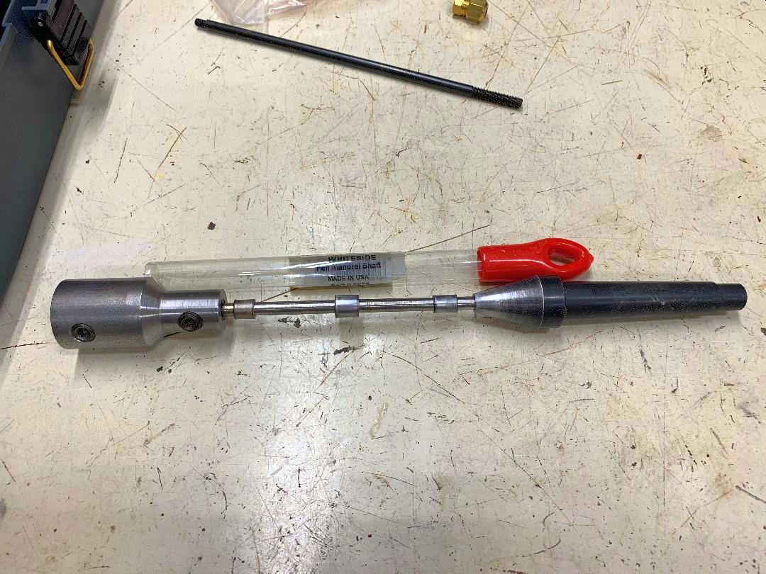

You might be able to save a few $ if you already have the shopsmith 1/4" router chuck. You can just buy the mandrel shaft (about $7 at woodcraft) and use the router chuck for the drive. That is what I do.
https://www.woodcraft.com/products/repl ... en-mandrel
If you happen to have the notion to buy a Lathe Pen Mandrel Saver you can then just buy drill rod and have a really nice set up. If you don't go this route then make sure you get a decent live center for the tail stock end.
pen set up.jpg (179.9 KiB) Viewed 17605 times
