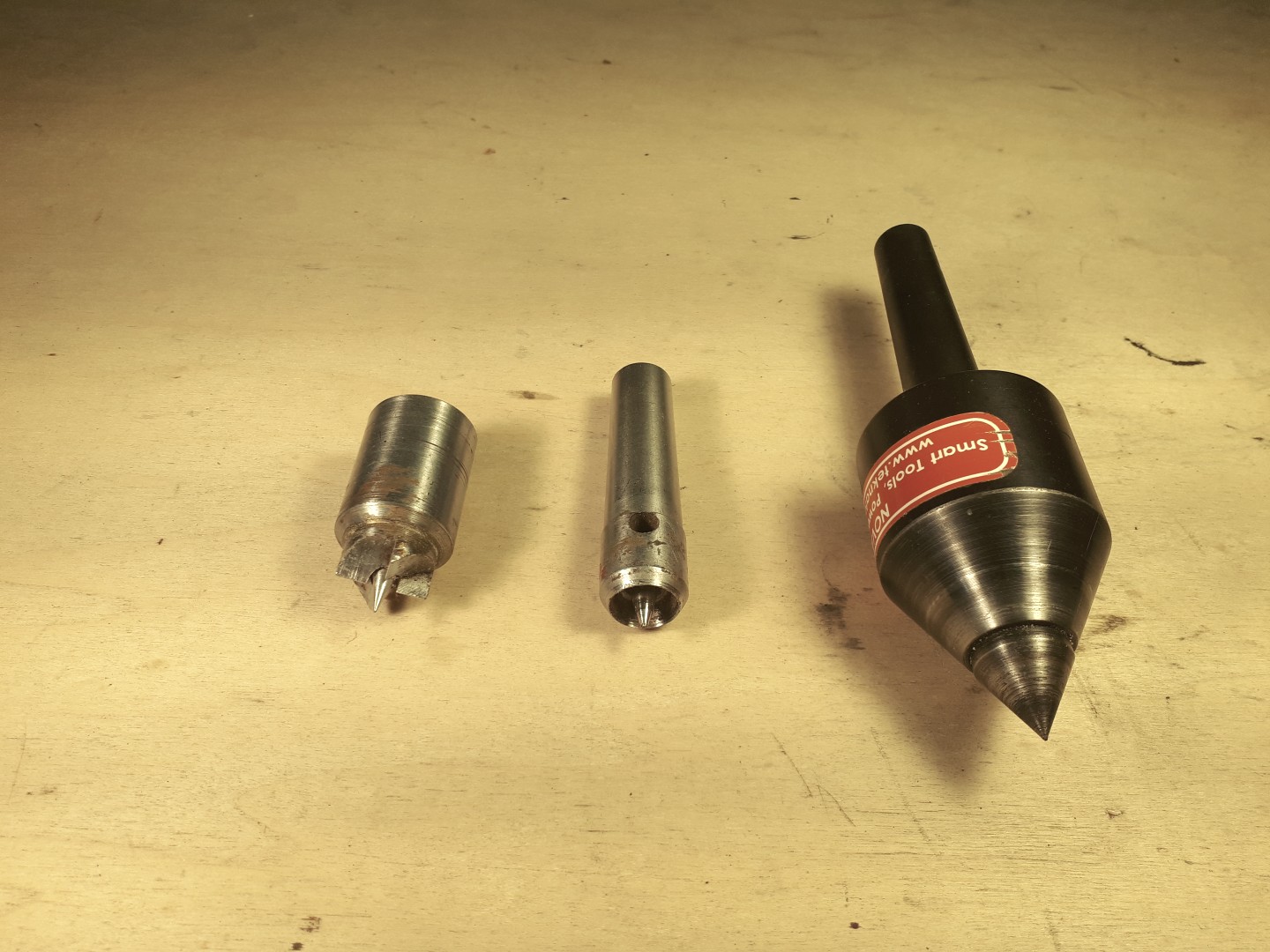

by rpd
Left to right there is a
- Drive Center- goes on the spindle - grips the work and makes it turn
- Dead Center - goes in the tailstock - supports the other end of the work but does not turn, requires lubrication to minimize friction.
- Live Center - goes in the tailstock - supports the other end of the work but has bearings so it turns with the work.
lathe centers.jpg (287.03 KiB) Viewed 15568 times
