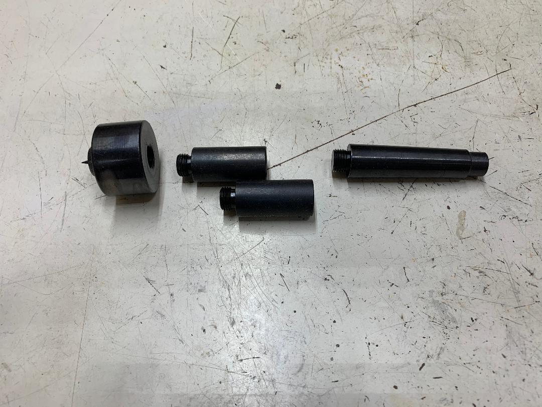

Just wanting to know. If anyone knows if the live center that is used with the duplicater is different from the regular one, that comes with normal SS tools? Seems that the normal one is a little bit short for duplicating. I picked up a duplicater and having some difficulty with making new handles for chisels. T Y. DOW. Indy
Re: Lathe Duplicater
Posted: Sun Aug 30, 2020 9:03 pm
by reible
It is the same center. The head part unscrews from the tapered part and there are two extensions that can be added. I think they came with the duplicator.

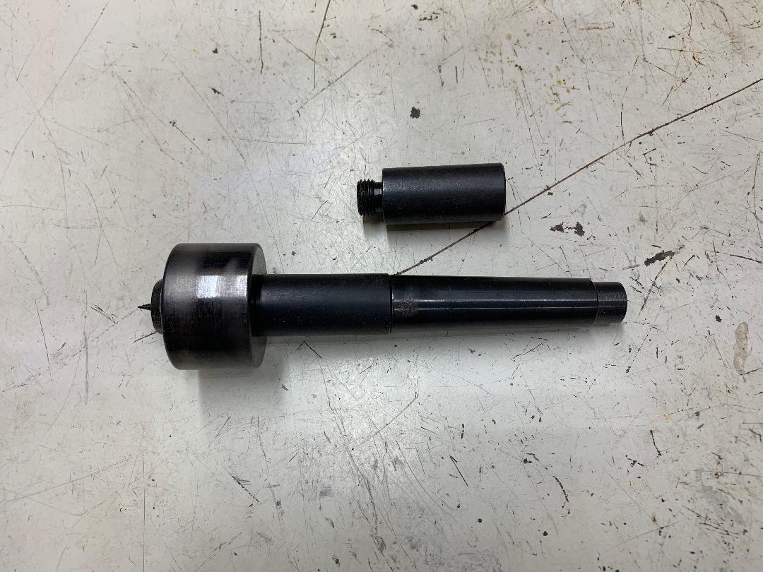

by reible
I might have added another?? Anyway I have two.
Posted: Sun Aug 30, 2020 10:16 pm
by reible
In pictures:

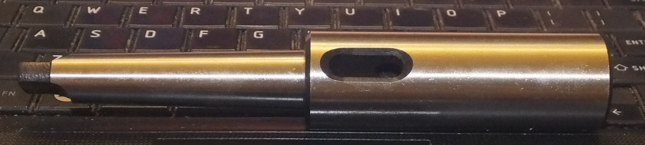

Another option would be an#2MT extension.
https://www.amazon.com/Morse-Taper-Exte ... B01BTBTDWO
Posted: Mon Aug 31, 2020 12:41 am
by JPG
YEP!
m2 - m2 adapter.jpg (589.57 KiB) Viewed 4686 times
Paid a lot less than 48+.
