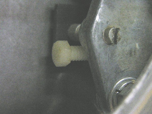

Something the early Bandsaws did not have is the Nylon Bolt (shown in the picture below) as part of the Guide Bracket Assembly. It helps with the alignment of the Upper Guide Assembly and can be added to an existing Guide Bracket by drilling and tapping a hole to add the Bolt or purchase a Guide Bracket Assembly that has it.
