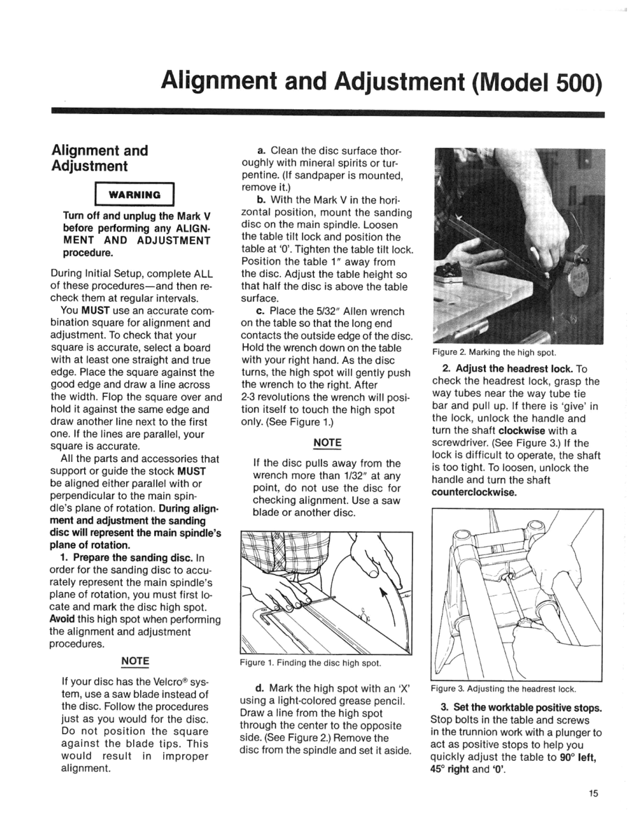

If you and your buddy do not have one already, download the Free 500 Summary Manual from Shopsmith directly. It is at http://www.shopsmith.com/getting_started/500_Summary_Manual.pdf
They too show using the long allen wrench with a sanding disc in a bit of a different manner than I mentioned. I have attached the page illustrating that from the manual for your review.
In it they say don't use the disk if it is 1/32" off. I don't use it if it is far less than that. More like .001" Keep a good flat one handy for alignment tasks.
