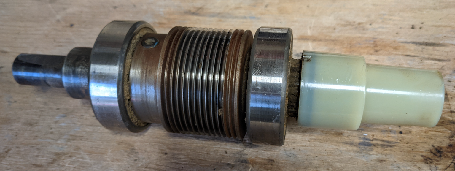

(2) I'm also replacing quill bearing (I have the single bearing quill) plus both drive shaft bearings, and the entire idler bearing/shaft which I purchased new on Ebay (the old single bearing version). For the bearings that require being pulled/pressed on/off, my plan is to use a regular bearing puller to get them off then carefully tap the new ones back on using a section pipe that can fit right down against the inner bearing surface. Again, does this approach seem safe? I'd rather not have to send these pieces out to be pressed on or buy a hydraulic press myself but will do one of those if people think my DIY approach is a terrible idea.
(3) On that note, one side of the drive shaft has a plastic part that prevents me from either taking off or replacing the bearing on that side. What is the best way to remove that plastic piece to get at the bearing? I was hesitant to pull very hard on it but I could fit the puller jaws around it if needed. Just didn't know if there was another trick to avoid breaking that part.

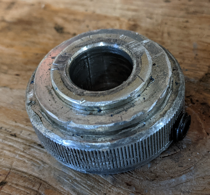

(5) Because of the smoke film (which maybe I should have cleaned better first) taking the collar off the quill was really hard and I end up marking up the quill collar pretty badly since the metal is quite soft. I think it is still fine (just cosmetic) and I could clean it up a bit, but it looks bad. I couldn't find anywhere to buy just this part online and none are on Ebay right now - any thoughts on where to find one of these or if I should actually be worried about how beat up it got when removing it?
