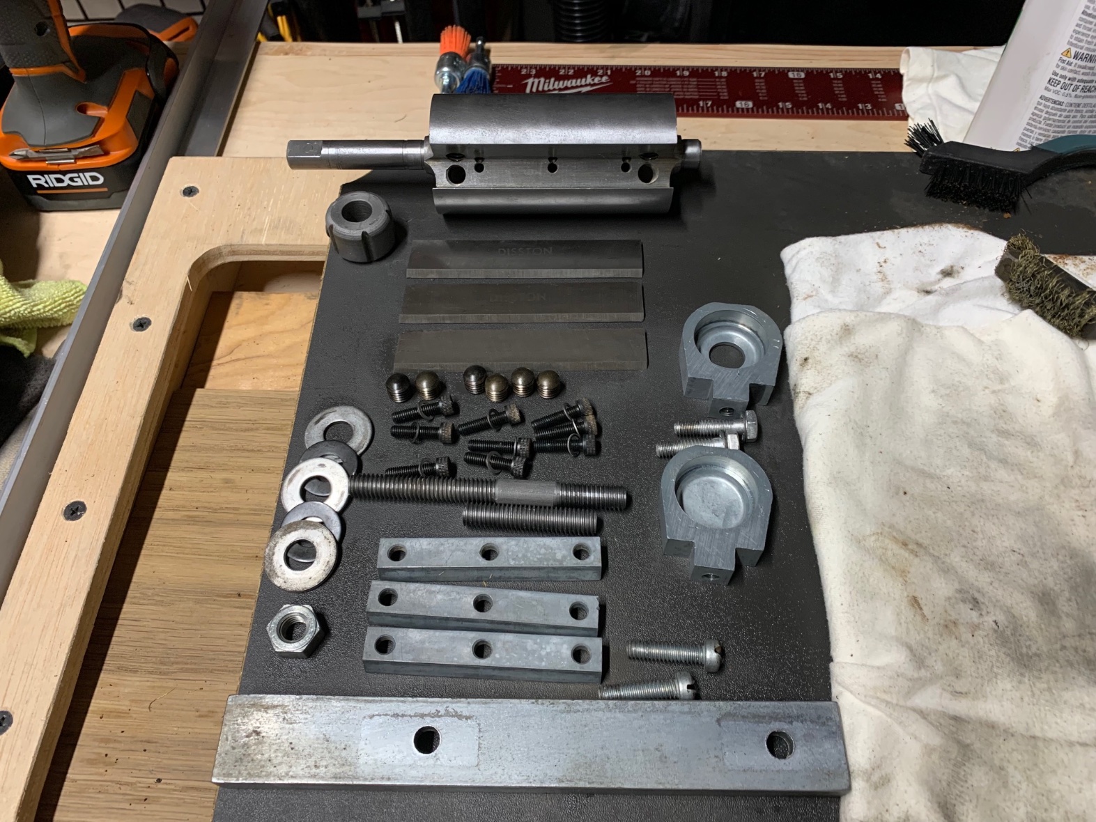

I pulled the cutter head apart and found very dry bearings, and one of them turns like a coffee grinder, even after oiling and spinning with a drill for several minutes. I ordered two new ones from SS, hopefully they show up this week.

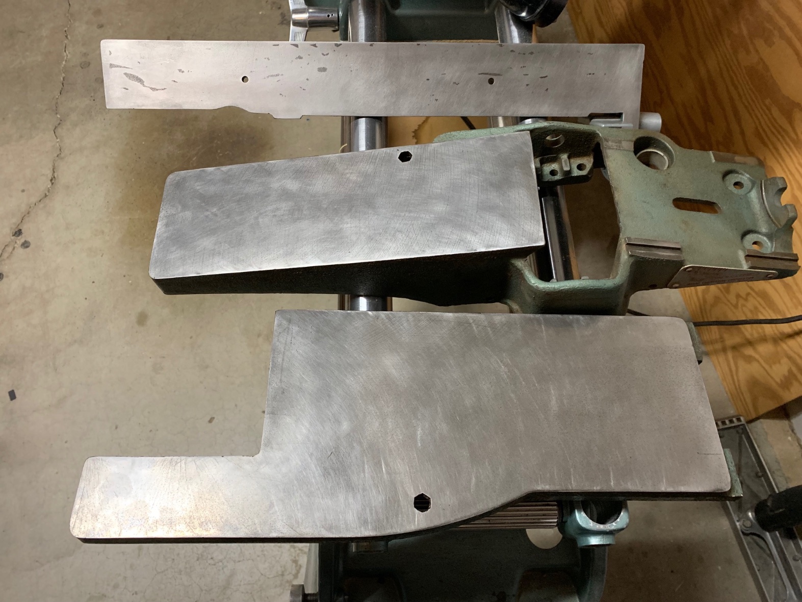

Found a lot of wood gunk and sawdust caked in the crevices underneath the beds. I’ve cleaned that out and found a lot of surface rust, so cleaning it up with the zyalox scrubbers (thanks for that tip!). Once all the rust is removed I’ll be ready to paint them.
I bunged up a few of the threads on the threaded stud used for the cutting depth adjustment knob because I did not realize the other threaded stud (used to hold the outfeed table onto the infeed table) was screwed down into it as a set screw to hold the depth adjustment stud in place. Since there was so much rust on the exposed threads I just thought it was rusted in place. It took a couple of turns on the depth adjustment stud before I realized the other stud might be screwed into it. This is not a huge deal since there are so many threads on that stud and it’s screwed deeply into the infeed table. Used a 3/8” NC die to clean up the threads.
Because of their dull gray coloring, I initially thought the fence adjustment bar on the right side of the infeed table and the depth adjustment knob were both made of aluminum. I did think that would be very strange because of the weight and stresses on these parts would be high. Still, I thought it was weird that I found no rust on either of these parts. Since they are heavier than I would expect I’m pretty sure they are not made of aluminum. Does anyone know what material these two parts are made of?
Here are a couple of photos of my progress.
