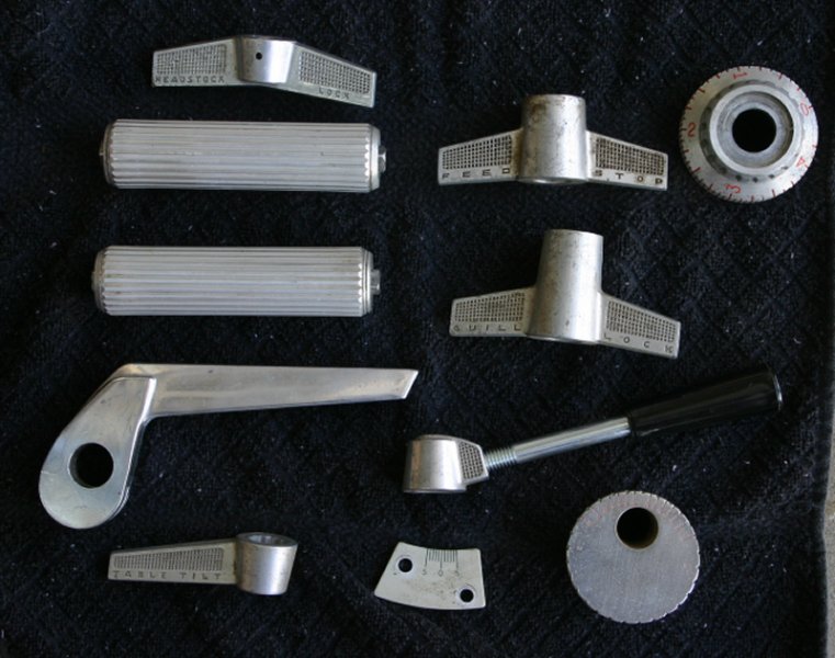

Anyway, I've begun doing the aluminum polishing on my '55 Greenie. My plans are to do these parts (possibly excluding the Sleeve and Insert Assemblies (part ref. 11, 22).

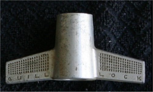

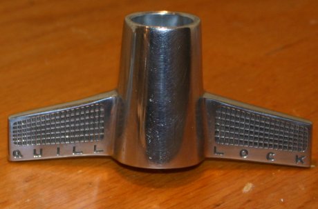

Initially, I thought that I would just buff the parts with the "as cast" surface to get a little shine on them. I ran into some "issues" though with not being able to buff the compound off effectively. Have ZERO polishing experience, I had to forum jump to the caswell site and ask for help. Here's the thread. The problem was determined to be due to the rough “as cast” surface finish. The compound would get into the pores. As you buffed, it would slowly pull the compound up out of the pores. This not only caused the problem with me not being able to buff it off BUT, it also created a cross contamination issue when going through the 3 different buffing compounds / buffing wheel combo. Not a good thing when polishing and fortunately, they were able to tell me what I needed to do to get my buffing wheels cleaned up. Since you use a different wheel for each compound, it's critical that you don't cross contaminate.
So here’s where the blessing vs. the curse come in. Being someone who has one set of standards (doing it RIGHT), I tackled the job of getting rid of the “pores” on the casting by sanding prior to buff. My thread at the caswell forum covers the sanding details. Needless to say, 4 hours later, I had a finished piece and p.s….I started at 9:00 pm, on a workday. Here’s the before and after.
The process was painfully slow due both to my inexperience and that fact that sanding was done without power tools. (Man, we’re spoiled!!). I just didn’t have the right equipment to use. What would have helped tremendously is a small jitterbug sander and a narrow ½” vertical belt sander although I don't know if I trust myself with power yet. Instead, I used a piece of 1"x4" mirror with the sandpaper wrapped around it so that I was sure the surface would be dead flat. Doing it with finger pressure would not have keep the surface flat and that would have definitely showed up on the final part (at least to my eyes it would…..real picky).

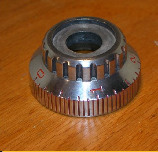

Here's my other before and after of the feed stop.
