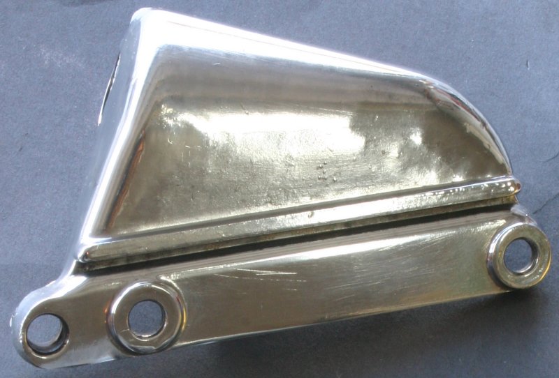

I came across a VERY ACTIVE forum at the Caswell Plating website that some of you may be interested in if you want to get more involved in polishing. I went there because I decided that instead of painting my caster supports, I am going to polish them instead.mickyd wrote:I wanted to share this link with the group. I am in the polish mode on my Greenie and found this guide very helpful.

[ATTACH]3559[/ATTACH] [ATTACH]3560[/ATTACH]

George,
I haven't used the type of Harbor Freight kit you show YET. The way I got the piece to look like it does above is using a 3/4 HP bench / polishing grinder along with 3 different 8" buffing wheels (spiral sown for black, loose cotton for brown, and flannel for white buffing compounds). Each wheel ONLY sees the one compound as to not cross contaminate. I will eventually have to use a kit similar to the one you indicated Harbor Freight but that will be for the finer detail. Right now, I am trying to get some of the gross surface defects out which I'll have to do with sandpaper. That's the info I am looking for from the other forum. I don't know how to proceed safely there since the surface is contoured and I don't want to botch it up.
I am probably going further into the cosmetic aspects than I have to but I want to learn just how to do a "show quality" buffing job for another application I am going to work on down the road. My ShopSmith will be a good "Guinea pig".

George,curiousgeorge wrote:mickyd,
Have you tried something like this?...
http://www.harborfreight.com/cpi/ctaf/d ... mber=98707
