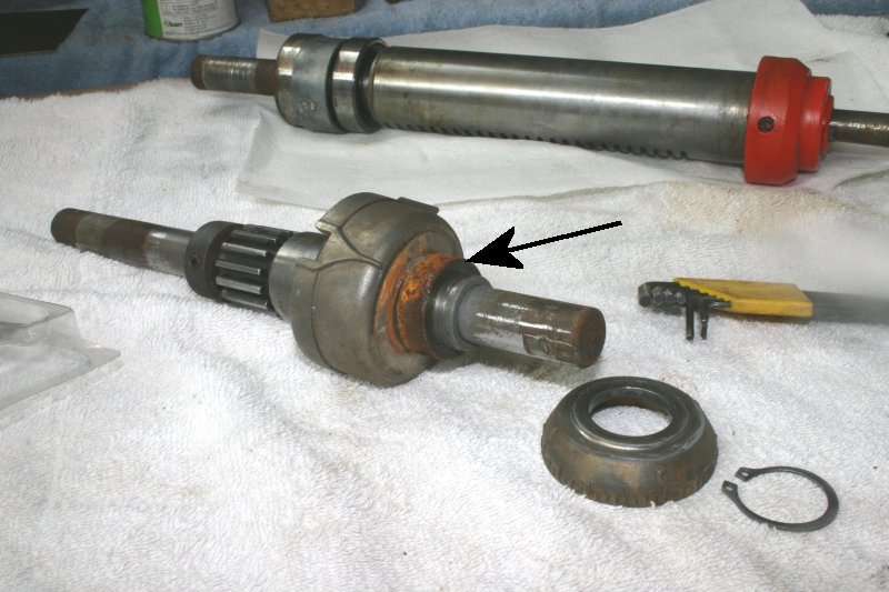

In my last post, I was trying to get the frozen rusty collar off the quill feed shaft (aka pinion shaft).
I had used "Kroil" spray applied several times each day over a couple days to try and unfreeze it. I decided it was time to try and take it off. It wouldn't budge by hand. Tried tapping with a hammer and punch and that didn't help either. Tried inserting a 1/4-20 x 1" bolt into the set screw hole to use as a lever arm to twist it off which worked so successfully at removing the quill lever knob a few posts back. All that did was bend the bolt. Decided that I would just use my bearing puller. If that wouldn't get it off, nothing would. Incidentally, I've yet to see the proclaimed miracles of the "Kroil" spray. It's 0 for 2 in getting my frozen parts unstuck. Not saying it's NG but just hasn't worked in my two applications. Bearing puller worked like a charm. The collar came off easily. It was heavily rusted at the shaft interface.

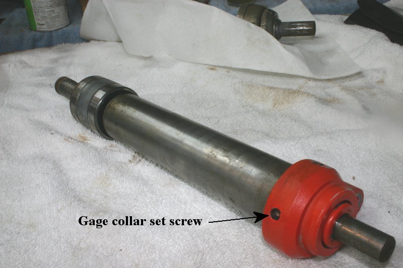

Next "quicky" task before calling it quits for the night (getting tired) was taking off the quill end cap (aka gauge collar) so that I could inspect the quill bearings.

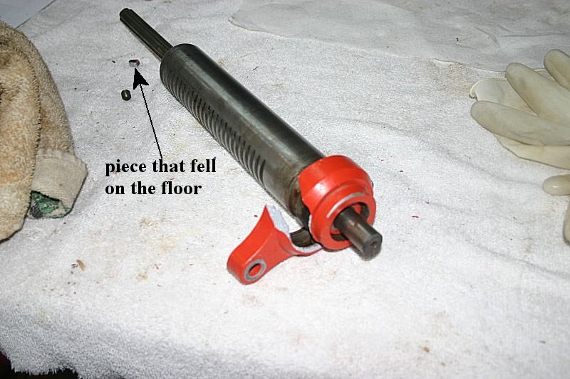

I removed the set screw holding it on and tried pulling it off. Wouldn't move (gee....with all the frozen parts I've run into on the machine, that didn't EVEN surprise me!!). Since I had my bearing puller out already, decided not to even mess around with with any other removal method. Put the puller on it, cranked it a few turns and heard that nice SNAP sound of a rusty bond breaking loose and the puller started turning freely. Made a few turns and heard something hit the floor. Looked down and saw the unique orange color this ER10 is painted on a TINY piece of metal. Picked it up and saw one side had threads on it.........not good. Looked closer at the gauge collar end cap and saw a HUGE crack with a set screw sitting right in the middle of it.
Well, when I took out the one set screw, I hadn't noticed that there was a second set screw 90 degree from it. You can just see the second set screw two photos back, on the top of the gauge collar. That's the one I DIDN'T see, thus didn't remove. The puller however had NO PROBLEM removing the metal that went all around it though!!
Looks like another job for J. B. Weld....NO. Looks more like a job for Bill Mayo......HELP MR. MAYO!!!
I'll try to locate a replacement part, however I will attempt to repair this one with J. B. Weld just because I have to see if I can. It will be good practice for me prior to my attempting the repair on the jigsaw mounting base.
