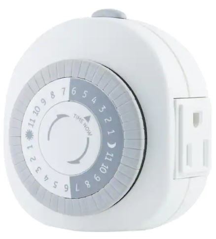

To solve that problem, I decided to bypass all the internal transformer-box timers, and control all four of the transformers from a single electromechanical timer switch, which I plugged into a 20A receptacle next to my load center. At time, I couldn't find a timer that was rated for 20A. But the total landscape lighting load was well under 15A, so I installed a generic 15A timer switch similar to the one below. Which worked just fine for the normal load, and now after a power outage I had only one timer to reset. It never even occurred to me that I should substitute a 15A breaker for the preexisting 20A breaker on that circuit.

Early one Christmas season, I was downstairs in my shop, and suddenly heard my wife yelling that smoke was coming from the closet where our load center lives. So I ran in to deal with it, opened the closet, and found that the 15A electromechanical timer was a smoking, blackened, melted plastic mess. :eek: As my wife kept adding more Christmas lights, I had completely forgotten that it was just a 15A timer switch. But fortunately, we were home and nearby, so the only damage done was to the cheap timer and to my pride. Under different circumstances, I suppose that our house could have burned down.
For a resistive load like a switch contact, the heat generated is proportional to the square of the electrical current. So at 20A, the heat generated is (20/15)2 = 1.78 times greater than at 15A. Although the difference in current doesn't sound like a lot, the difference in heat generation is quite large.
Following that wake-up call, I well and truly bullet-proofed the landscape supply circuits. First I installed a second 20A branch circuit, giving one 20A circuit per pair of transformers. Then I installed a 30A power relay in series with each of those branch circuits, with both relays mounted in a metal junction box. Finally, I bought and installed another generic 15A timer, but now it only switches the coil current to those two power relays.
