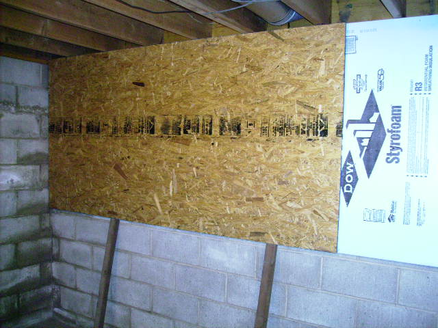

Finally getting in a little shop time again and got started on my wall storage system. Dang I work slow anymore. :rolleyes:
Before anyone worries, those are just old stains on that corner wall from many years ago. In spite of appearances that wall is stone dry and has been for a long time. I'm not sure why it looks so dark in the picture it isn't remotely that dark in real life. 🙂
Painting is a good ways away yet.
I'm using 1/2" foam board behind the panels then hanging both from the sill plate.

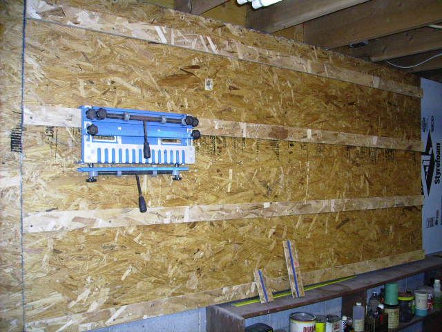

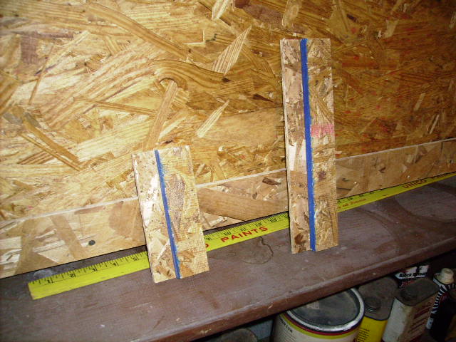

The rails are made of a 1.5" strip of 7/16" OSB as a spacer with a 2.5" front face of .25" OSB. Hangers will be identical but flipped. Everything is glued with Titebond. The faces of the rails are glued and stapled (air nailer/stapler) to the spacers then the rails are glued and screwed to the panels. This section is where my bench will sit about 4' or so from the wall and I will generally work standing between the bench and the wall with my back to the panel. This section will mostly be misc. hand tools like chisels, screwdrivers etc.
I felt the need to hang something up so I grabbed the dovetail jig that has an "L" flange on the back and hooked it over a rail. 🙂 Some of this area will be some smallish peg board panels. I have a lot of pegboard hooks and hangers from our store.
One 8' panel done, 9 more to go...
