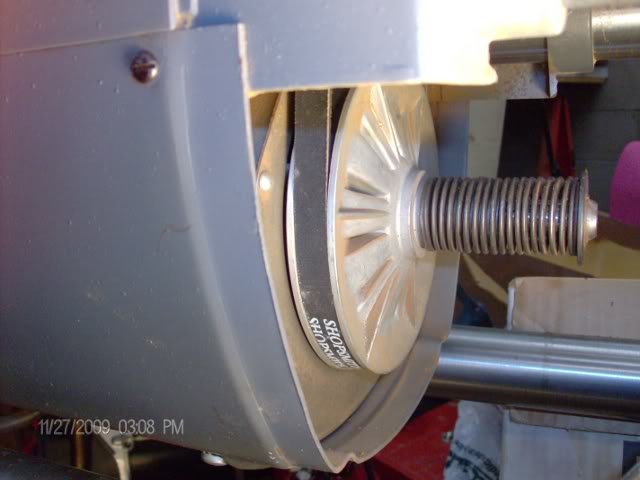

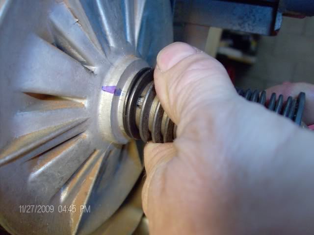

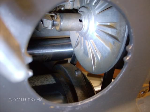

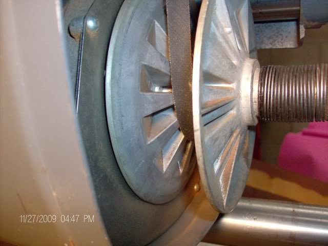

I hope these help you ID the moveable sheaves. Proper and regular lubrication of the sheaves is needed to achieve smooth speed changes.zamlet wrote: ↑Wed Apr 14, 2021 1:05 am OK, cool, thanks! I'm not certain what you're referring to by "moveable sheaves", and I don't really trust myself to be able to spot places that need oil vs. places that emphatically do NOT need oil, but hopefully the manual will make it clear.
Is machine oil really sufficient? I figured I'd probably need some grease somewhere.
The first and the last images show the holes where the machine oil is to be applied. I am inclined to apply far more oil (eight to ten drops) than the maintenance instructions call for. I put some in and then run the speed dial up and down a couple times and then do it ALL over again. I do this about every six months. I am (I believe) a typical Shopsmith user.
