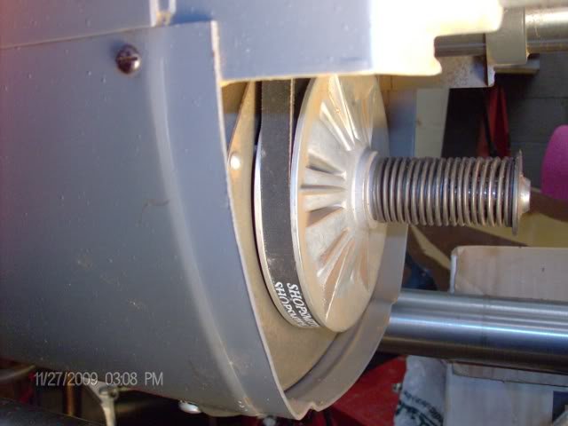

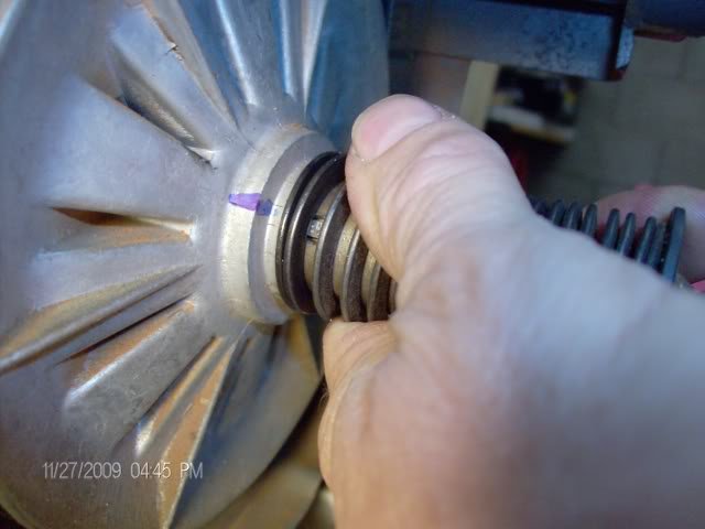

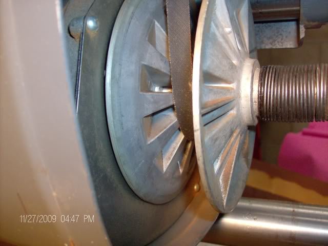

I hope these help you ID the moveable sheaves. Proper and regular lubrication of the sheaves is needed to achieve smooth speed changes.
The first and the last images show the holes where the machine oil is to be applied. I am inclined to apply far more oil (eight to ten drops) than the maintenance instructions call for. I put some in and then run the speed dial up and down a couple times and then do it ALL over again. I do this about every six months. I am (I believe) a typical Shopsmith user.

Since your Shopsmith has been sitting for a long time I would go with the advice of using more than the recommended number of drops of oil this time around. As has been stated you don't want to over do it either. Oil on surfaces in the headstock will collect dust and "gum" things up. There is a balance here. Dusty posted some great pictures showing the two pulley assemblies and where to lubricate the floating sheaves on those two pulleys. The top picture is looking in through the access hole on the back side of the Headstock. This one happens to be a "B" Headstock and the logo plate cover is pried off. It takes little effort to do that. Note the hole in the sleeve which is where the drops of oil go. The other three picture show the motor pulley which is accessed by removing the screws for the belt cover and sliding it away from the headstock on the way tubes. The bottom picture shows Dusty locating the oil hole under the spring.
