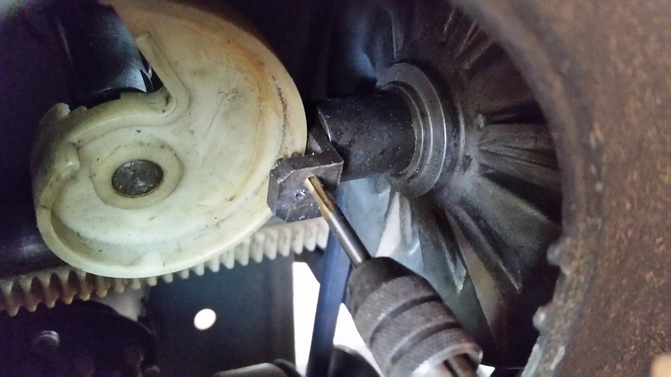

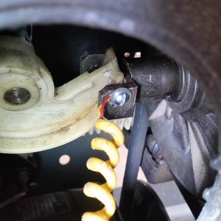

As most SS people know by now the weak link in the MK VII is the plastic speed adjusting cam melting caused by the control sheave bearing overheating/siezing up.
I think I have a fairly easy and inexpensive way to monitor the bearing temp while it's running.

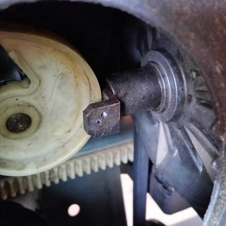

Thru the back inspection cover hole I drilled and tapped a 6-32 hole in the side of the cam follower (pic 1).
Then I took a length of type K thermocouple wire; twisted the ends together.
I took a short 6-32 screw, flat washer and lock washer; screwed it in the threaded hole in the cam follower; put the bear end of the thermocouple wire under the screw and washer and locked it down.

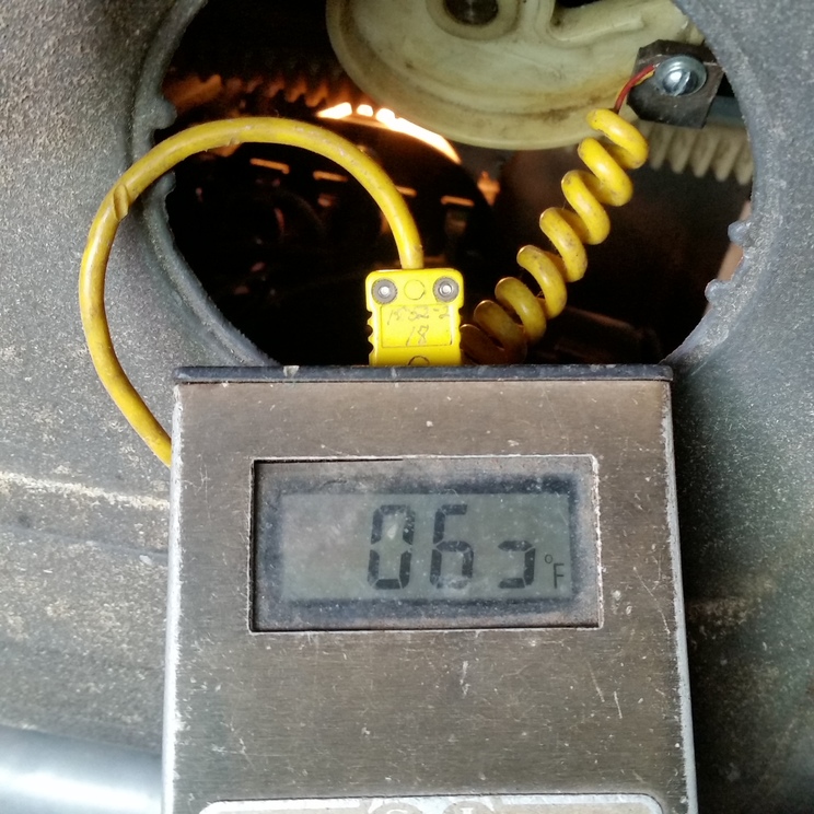

Now with my type K digital pyrometer I can monitor the temp of the cam follower and bearing (my LCD display doesn't work too good anymore but I can still decypher reading)see pics.
I ran the ss for about 7-8 minutes; the temp went from 74 deg to 87 deg.
With this method you can monitor the temp as you work;find out what the normal operating temp is; and if it goes above that you know to lube or replace the bearing before catistrophic failier.
I found several thermocouple meters with a thermocouple wire for under $15.00 online.
I just set mine up for experimentation. If I wanted pretty it up I would drill a 3/16" hole in the back headstock cover to feed the thermocouple wire thru; leave some slack in the wire to allow control sheave movement and mount the monitor out front somewhere.
I hope my pics come across ok. I haven't tried this before.

I started this thread a couple years ago now I got some projects going where I could get some time on my mk VII and get some temp numbers.
Nothing scientific, just temps over time.
Doing lathe work mostly steady with a few short stops; temps were about 107 deg in 30 minutes and about 115 deg in about 45 minutes.
Another day I was running the jointer mostly for about the same time and temps were about the same.
This is interesting info. I don't know what the max temp would be but it wouldn't be over 400 deg ( which is what it would have to be in order to melt the nylon plastic the cam is made of) unless the oil in the speed control bearing burnt off and seized up. I don't know, maybe the oil could burn off after running steady for 2 hours at medium speed.
I worked with thermocouples in the plastic industry for nearly 40 years. If you want more info on them, let me know.

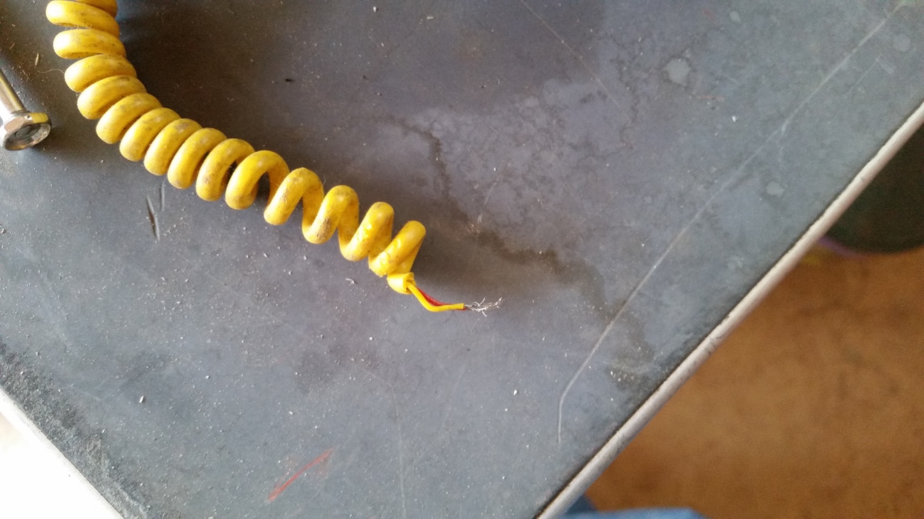

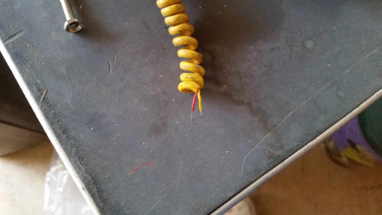

Re: MK VII control sheave bearing temp monitoring
Well that explains the yellow coil cord!

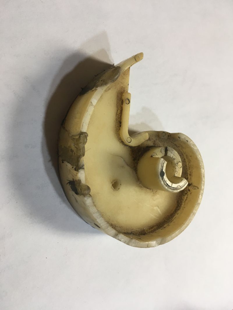

Plastic cam; this is the only pic I have of a damaged plastic cam. It is so damaged it's hard to tell if it is melted or smashed. I think it melted from a seized bearing and someone tried force it with the speed control in its melted state.

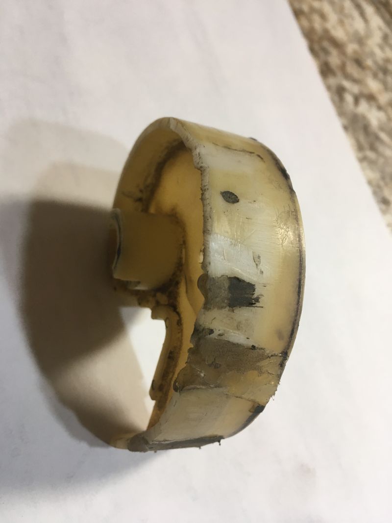

Here is a Mark VII cam from a unit I bought for parts a few years ago. The bearing had overheated and melted the cam in several spots. I filled the voids with hot glue to use it as a pattern.
- IMG_0420.JPG (65.68 KiB) Viewed 8475 times
