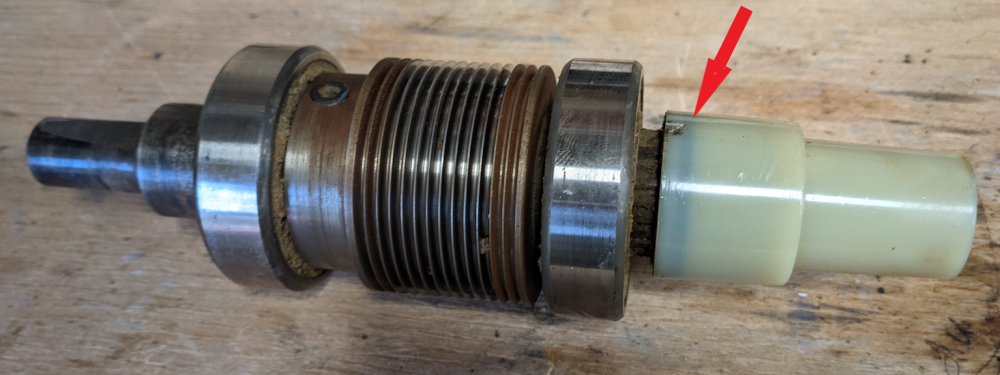

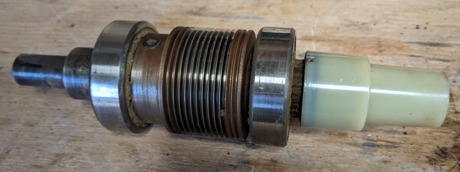

(3) On that note, one side of the drive shaft has a plastic part that prevents me from either taking off or replacing the bearing on that side. What is the best way to remove that plastic piece to get at the bearing? I was hesitant to pull very hard on it but I could fit the puller jaws around it if needed. Just didn't know if there was another trick to avoid breaking that part. (4) The way tubes, where they attach to the pivot side, are surprisingly wobbly which makes me worry accurately adjusting the lathe tailstock would be difficult or the tailstock would wobble while turning. They tubes wouldn't come out but I also couldn't locate a set screw for how to remove them (or just tighten them up to prevent the wobble. Is there a trick to this and/or is that kind of wobble actually ok?

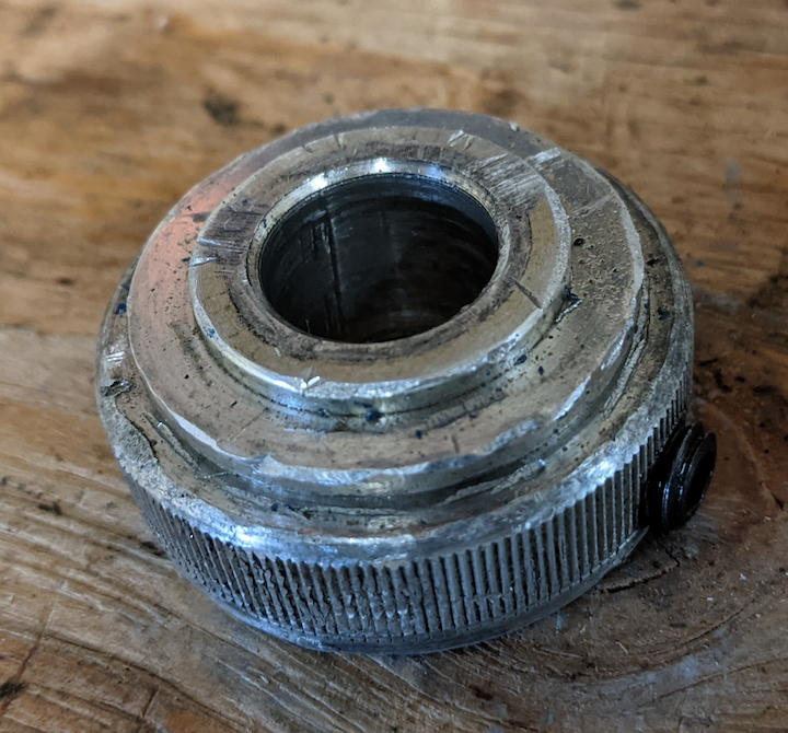

(5) Because of the smoke film (which maybe I should have cleaned better first) taking the collar off the quill was really hard and I end up marking up the quill collar pretty badly since the metal is quite soft. I think it is still fine (just cosmetic) and I could clean it up a bit, but it looks bad. I couldn't find anywhere to buy just this part online and none are on Ebay right now - any thoughts on where to find one of these or if I should actually be worried about how beat up it got when removing it? Thanks in advance for any help or suggestions!

The Quill Collar should be fine to use just clean up/file down the rough spots without changing the original dimensions. Most of the damage will be hidden anyway.

The plastic part you referred to in #3 above is called the Drive and Ring. This part can exhibit wear, especially with a single bearing quill. You can check its fit on the quill when you have it off. IIWM I'd be likely to replace it if I was replacing the quill bearing. They are about $9.50 new from Shopsmith. Due to shipping, I'd try to come up with a complete shopping list first.

If you do come across a quill collar be aware that there is more than one version. I don't know how many versions, just that it is at least two.

I agree with all above. IIWM I would just use the quill bearing retainer as long as the inner face is burr free.(dents ok)

- I filed the high spots down on that collar and it looks good now.

- I ordered a new Drive & Ring but I still don't see exactly where that retaining ring is that people mentioned. Is it down inside looking in from the end? If so man that is deep, and I couldn't feel anything down there with my pick. Or is the snapring holding on the plastic drive piece on the fatter, bearing side on the other end? Either way I couldn't see anything. Can someone post a picture of it or link to a video of someone removing the ring?
Someone here mentioned it should be pried out using a wide screwdriver, does that seem right?

The spring in the plastic drive is integral to the part, and gives it a friction fit on the drive sleeve. The plastic part just pries off, you don't remove the spring first.

It would appear a PO greased the nylon sleeve. Not necessary. A carry over from the earlier models which had all steel sleeve and splined shaft.

The ring holding the plastic Drive & Ring (P/N 514083 reference #57) for the Drive Sleeve Assembly is inside the part located where the arrow is pointing in the picture below. It is simply a round wire ring meant to hold it there.
