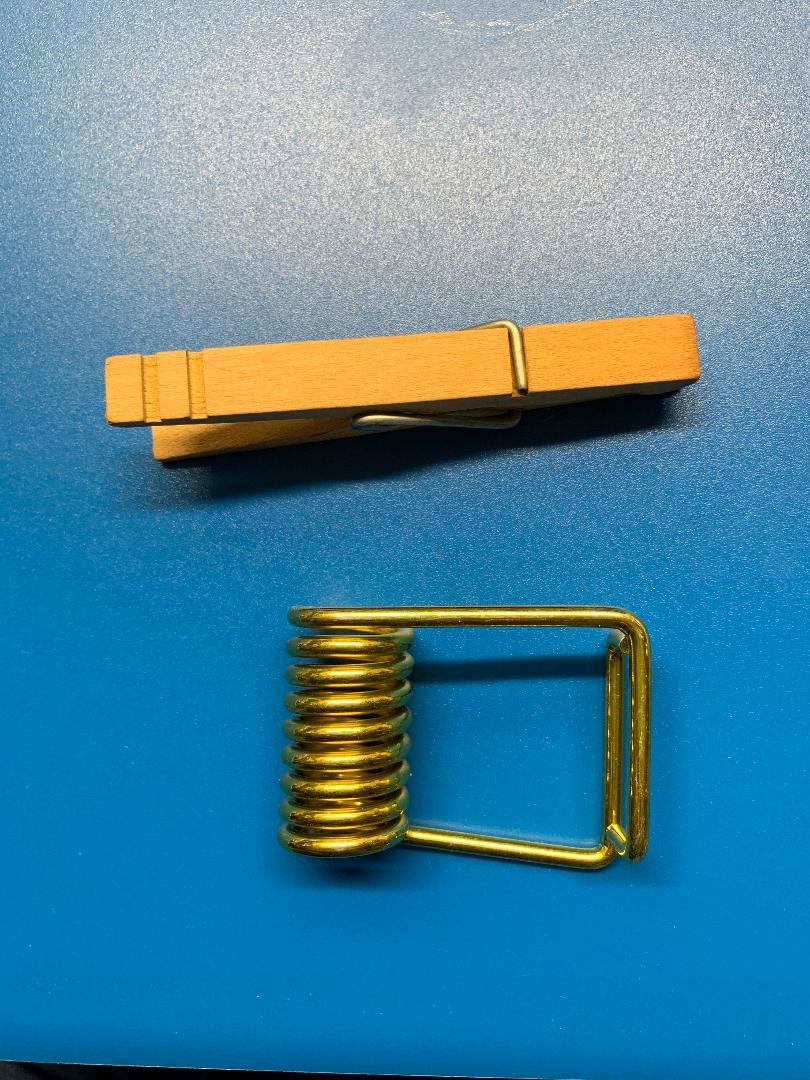

Got my springs today. Don't have the large size designed yet but I can show the large spring vs the standard clothespin.

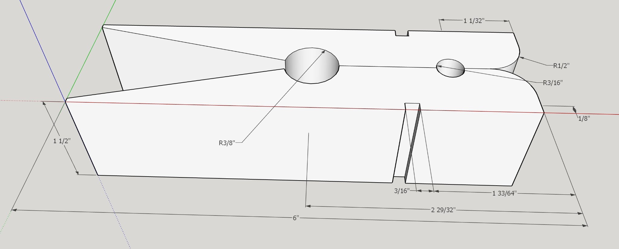

First cut of a design shown. Will attempt to build a 1/2 of one to see how it's starting to look, maybe pine, or if I have some scraps of hardwood that might work, will see.
ScreenHunter 65.jpg (95 KiB) Viewed 4067 times
Plans subject to changes as I go....... so if you decide to try this let me know how it works or just wait for me to make one at some point.
Re: 8 inch clothespin plans
Please note the 1-1/2" dimension is really 1-3/8", forgot to recapture after changes.......... sorry.

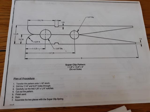

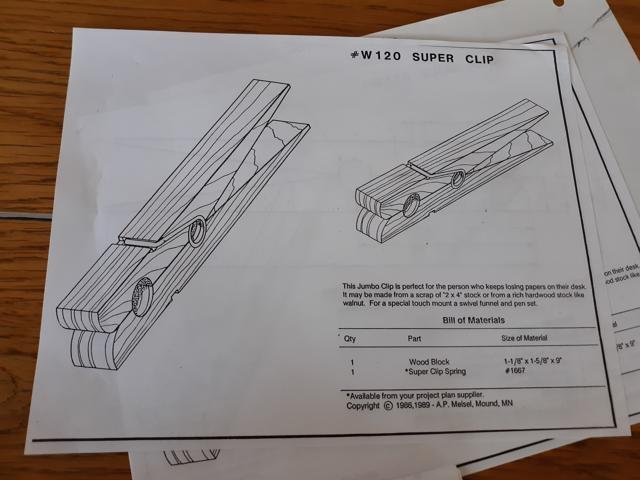

knew I had the plans, wasn't satisficed till I found them.
