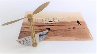

1878 Wright Brothers Bat -- The Home-made Toy That Began the Age of Aviation
Post by Chad »
Nick Engler's Workshop Companion
Watch it here: https://www.youtube.com/watch?v=9MpFTmb9Ytk
In 1878, the Wright brothers' father brought them a rubber band-powered helicopter. Young Wilbur and Orville played with it until they wore it out, then began making their own from wood and cork. Years later, after making their first flights, they credited this toy as having sparked their interest in aviation. Woodworking author Nick Engler, who has helped build many full-sized Wright airplanes and flight simulators for museums world-wide, shows how to build this historic model, the Wright brothers' first flying machine.
Plans for the Wright Bat are available at https://workshopcompanion.selz.com/​
And you can read more about this history-making toy and the Wright brothers at https://www.wright-brothers.org/Histo...​
Pick up one of Nick's books FREE just for visiting: https://workshopcompanion.selz.com/categories/books
If you enjoy this video, check out our Workshop Companion Channel: https://www.youtube.com/channel/UCk480B ... hMfkBjhDpQ
And if you want clear, concise information on any woodworking topic, visit our Workshop Companion web site: http://workshopcompanion.com

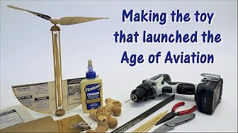

1878 Wright Bat -- Detailed How-To Instructions (and a little archaeology)
Post by Chad »
Watch it here: https://www.youtube.com/watch?v=T3fg8GDvbrU
Nick gives a blow-by-blow description of how to make the 1878 Wright Bat. He also reveals some interesting information on who might have made the original bat, the toy that inspired the young Wright brothers and got them thinking about flight. If you’ve watched or time-lapse video and would like more detailed instructions, this is for you. Better yet, if you’d like to help a young person make this model helicopter, perhaps for a History Day project or a science fair, then this is for both of you.
And don’t forget that we offer detailed plans for the Wright Bat from our store at https://workshopcompanion.selz.com/it...​

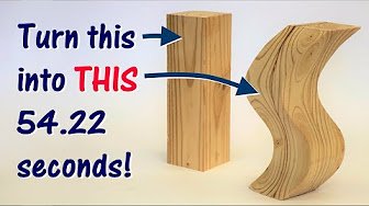

Bandsaw Magic - Little Known Compound Cut Technique
Post by Chad »
Watch it here: https://www.youtube.com/watch?v=DteAwffOnqI
Nick has always loved this trick. Cut a curve – any curve – in a block of wood. Put the two pieces back together, turn them 90 degrees, and cut another curve – any curve. Turn each of the four pieces 180 degrees and – presto! – this is what you get! Works every time.
If you enjoy this video, check out the Workshop Companion Youtube Channel: https://www.youtube.com/channel/UCk480B ... hMfkBjhDpQ
And if you want clear, concise information on any woodworking topic, visit the Workshop Companion web site: http://workshopcompanion.com

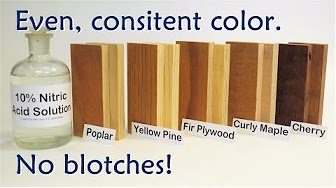

Nitric Acid – A No-Problem Stain for Problem Woods
Post by Chad »
Watch it here: https://youtu.be/Q_g2LjjnHuM
Nitric acid is my go-to stain for hard-to-stain woods. The results are always even and consistent, never any blotches, no surface conditioner necessary. Just mix up a thin solution (5% to 10%), apply and let it soak in for a few minutes, and then hit it with a heat gun. A beautiful brown color will develop as the acid oxidizes the wood surface. Not only is this a good chemical stain for problem woods, you can use it to restore antique patinas and simulate old wood. Be sure to read the safety concerns I posted in the Comments.

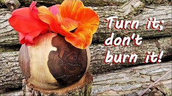

Turned Firewood Bowl – Bark Included!
Post by Chad »
Watch it here: https://youtu.be/7aWwLFiQA6U
A neighbor gave me some logs from an ancient walnut tree he had to put to rest, and I’ve been having a fine time with the remains. The wood is still green enough that the bark hasn’t begum the separate, so I’ve been making some “bark-included” turnings – this bowl is one example. It’s a short log turned sideways! I wet the log from time to time while turning it, and place it in a plastic bag between lathe sessions to keep it from drying out. Once the turning is complete, I soak the bowl in polyethylene glycol (PEG) for several days to slow the drying process, keep the wood from splitting, and keep the bark attached to the wood.

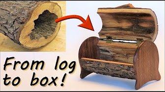

Location: West Milton, Ohio
Making a Hollow Log Chest
Post by Chad »
Watch it here: https://youtu.be/QhoQTxr4EBA
I rescued this hollow basswood log from a woodpile, sealed the ends, and let it dry in my shop for several years. Because it was hollow, it dried from both the inside and the outside evenly, shrinking slowly and uniformly. This allowed the bark to stay firmly attached -- just perfect for a bark-included log chest. I scooped the rot from the inside, added walnut ends and a small, crooked sycamore limb to serve as a handle. This is the result!
#Woodturning​ #Turning​ #Woodworking​ #DIY

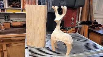

2x4 Reindeer
Post by Chad »
Watch it here: https://youtu.be/zz4lVwmFYZw
#shorts - Wondering what to do with all those 2x4 cut-offs? Well, with a few simple band saw cuts, you can turn them into reindeer! If you'd like to see this woodworking project demonstrated a little slower, check out the extended video at https://www.youtube.com/watch?v=ho8XX.... And if you'd like the plans and a full-size pattern for these reindeer, they're available from our store at https://workshopcompanion.selz.com/it... .
