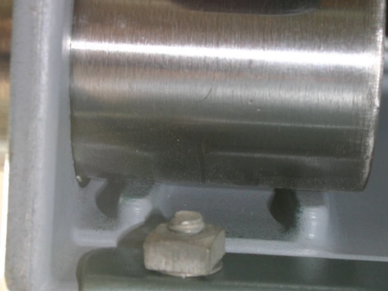

This is the ribs on Mickyd's Greenie(Thanks mike). Notice the shape is roughly square. I do not know the actual dimensions, But IMHO they are 5/16" x 5/16".

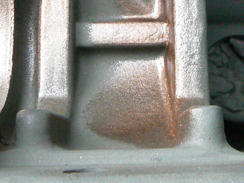

This is the same ribs on a Goldie casting. Notice the ribs are 'taller' than they are wide. Actual measurements are 5/16" wide x 3/8" 'tall'.

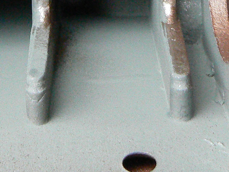

This is the ribs on the other end casting(away from the hinged end). Notice what appear to be added height to the ribs. These ribe are 'thinner' than the ribs on the hinge end casting. They measure about 7/32" x 7/16". This added height appears to be 1/16".

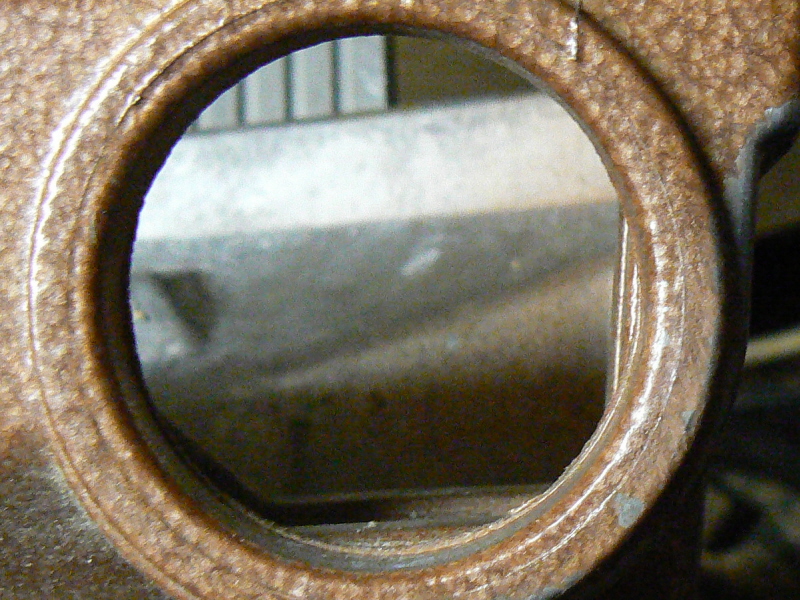

This is a near bore shot of the bench tube hole in the end casting. Notice the rib extending into the 'bore'.
The extra rib height positions the smaller(1 3/4") bench tubes at the same ctr - ctr distance as the larger bench tubes with an end casting with shorter ribs.
The inner side of the bench tubes is positioned by the clamp which has a bevel which forces the tube tight onto the ribs. I do NOT believe these clamps vary from model to model.
