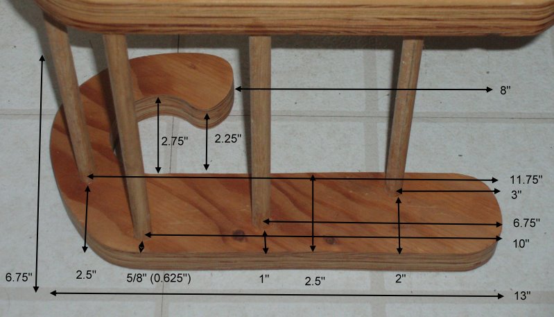

chisel cradle
Took a few measurements...
I made this from sight & my chisel set. You might change dims if you see fit.
Used 1/2 inch dowels.
