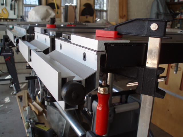

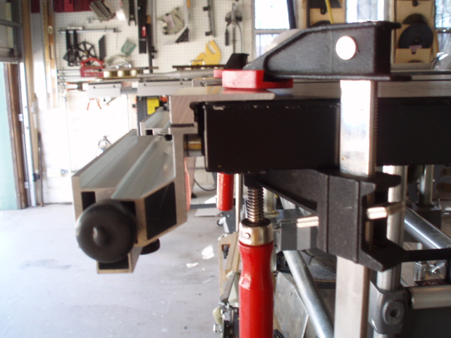

As a precursor to discussing any alignment procedure that I have devised for the tables and rails I believe it would be wise to review the procedures that have been provided by Shopsmith.
There are two that seem to be appropriate. The first was subject of a Sawdust Session.
http://www.shopsmithacademy.com/SS_Archives/SS113/SS113_Aux_Table_Alignment.htm
The other is a procedure that can be found in the Shopsmith Archives/Product Manuals/Mark V 520 Rip Fence Scale Upgrade.
http://www.shopsmith.com/ownersite/productmanuals/MKV520_RipFenceScaleUpgrade.pdf
Assuming that these procedures all function either by themselves or when performed in conjunction with one another is a prerequisite. If you disagree with those assumptions, you need not read on.
For my own use, I have sort of combined and modified the procedures.
I attach the rails to the table/tables but do not secure the mounting bolts. The rails can be moved around for later placement. I then install a pair of extension tubes (front and rear) using the shortest tubes available that will span the tables in question.
I then use clamps to secure the aluminum gauges in place per the procedure mentioned above.
I then press the tables upwards against the aluminum gauges and secure the mounting bolts.
[ATTACH]2161[/ATTACH]
[ATTACH]2162[/ATTACH]
[ATTACH]2163[/ATTACH]

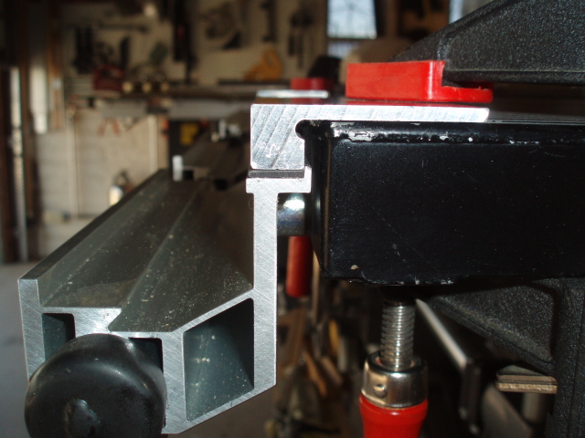

In photo #4, note that the bottom of the gauge is positioned on the magnetic strip and NOT on the aluminum rail. I don't know whether this is what Shopsmith intended or not but this is how I have been doing it.
I do the alignment this way because I feel the gauge location is more repeatable when it rests flat on the magnetic strip.
I believe that it would work equally well done either way so long as the gauge is located in the same position on every adjustment point.

Dusty both the descriptions and your super pictures will be a big help to many of us. Now if we can just get you to send those party invites before you enjoy the wine. fjimp:D

Great stuff Dusty.
The combination of the link to the Sawdust session and your pictures will get me where I need to be. I really need to see the actual "doing" of the process instead of reading the process.
I was placing my aluminum guages on the same corners of the rails and I see where placing them at the opposite ends will give me a better guide. The clamps are a great idea too.
It'll be nice to slide the fence without a little wiggle going from one rail to the other.
Thanks Dusty!

pinkiewerewolf wrote: I was placing my aluminum guages on the same corners of the rails and I see where placing them at the opposite ends will give me a better guide. The clamps are a great idea too.
Thanks Dusty!
There is no visual media available that describes the installation and alignment of the rails.
The aluminum gauges that I have were originally only one piece twice as long. I cut it to get the two pieces so that I could work opposite ends of the rail at the same time.
I hope that you are able to obtain and maintain a smooth transition as the fence is moved along the width of the table. I am not able to do that at some of the transition points. I can feel and hear the fence as it crosses over the joint.
I suspect that my rails are not "exactly" the same end profile is some locations.
I have not sensed that it effects rip fence alignment at all.
