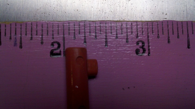

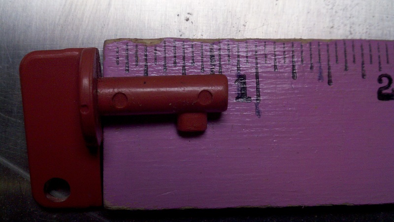

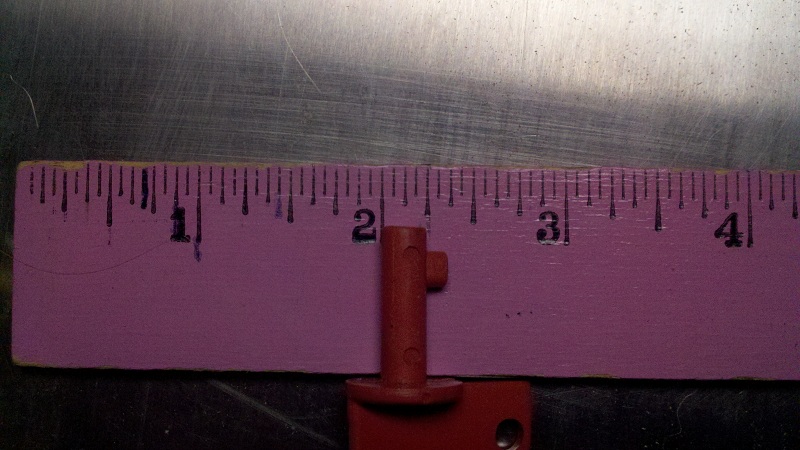

I have a planer pro that I purchased used. It did not come with a key. I have tried to order one from Shopsmith but they have none in stock and a shipment date may never be:rolleyes: . I am hoping that someone can take a picture with measurements so that I can "create" a key.

jcraigie
Posts: 505
Joined: Sun Sep 05, 2010 8:17 pm
Location: Fowlerville, Michigan
Post by jcraigie »
If it's not posted by then I will take a pic and some measurements for you when I get home tomorrow.

jcraigie
Posts: 505
Post by jcraigie »
Sorry for the delay:o Here you go if you need anything else let me know.
[ATTACH]13767[/ATTACH]
[ATTACH]13768[/ATTACH]
[ATTACH]13769[/ATTACH]
