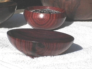

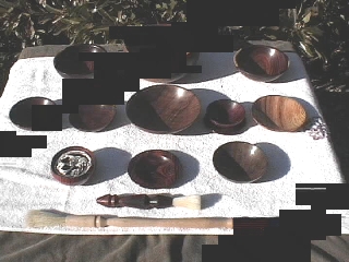

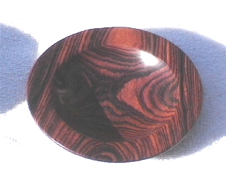

1) What DOES it sound like?
2) How did the bowls get attached?

The bowls are just some of my turnings-these pieces are from a piece of Cocobolo that I found in Mexico while on vacation.
