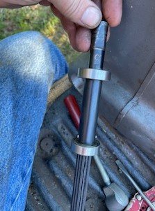

This one has a 2-bearing spindle.
- ss76.jpg (21.06 KiB) Viewed 10064 times
This is it dissected.

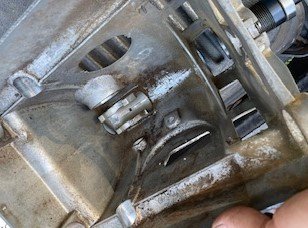

Carriage lock was froze I soaked it in Kroil.
- ss79.jpg (19.55 KiB) Viewed 10064 times

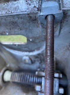

Removed this in stages
- ss80.jpg (17.01 KiB) Viewed 10064 times
Ready to clean a start afresh.

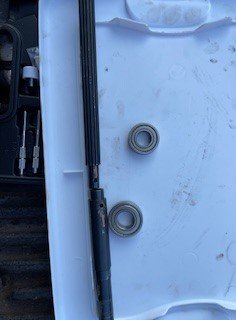

Setup to press spindle bearing off.
- ss92.jpg (21.63 KiB) Viewed 10064 times
This Required a lot of soaking .
It was stuck to the Spindle.
I don't know what this is used for.
But I'm sure Ya'll know.
Maybe cutoff disc?
- ss93.jpg (13.78 KiB) Viewed 10064 times

GetterDone wrote: Sun Sep 08, 2024 10:37 pm
Maybe cutoff disc?
Yes, see everything about arbors: (
viewtopic.php?t=22629)
I believe it is a 5/8" Universal Arbor, later re-identified as a 5/8" Molder/Dado Arbor. There are multiple versions. When I bought mine, roughly the time your machine was produced, SS did not have a 5/8" saw arbor and this was available to fill that need, thus Universal. This description presumes it is 5/8", there is a similar 1/2" product.
- David
